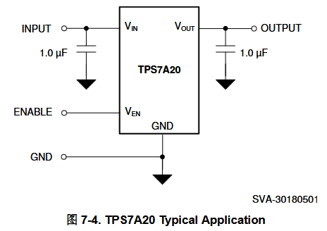

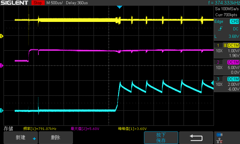

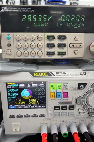

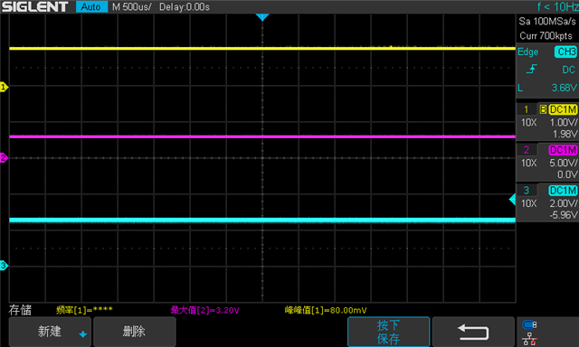

When the input voltage VIN is 5V and the load is 20mA, the output voltage Vout increases by 0.49V above the standard value.
Why did this situation occur?
