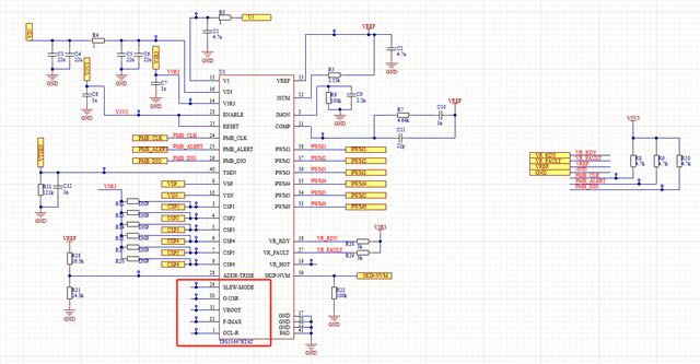

When I use NVM configuration mode, can I float the following pins?If nothing is connected, can the output voltage be normal?
SLEW-MODE、O-USR、VBOOT、F-I<AX、OCL-R

Yes these pins are to be floated in NVM configuration mode.
