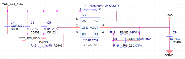

Hi,
We are planning to use the TLV61070A boost to generate 5VDC  (4.2V to 4.8V). But we need to limit the 5v output noise under 50mv.
These are the testing conditions:
  • Vin: 3.2-3.3Volt
  • Load :100Ω

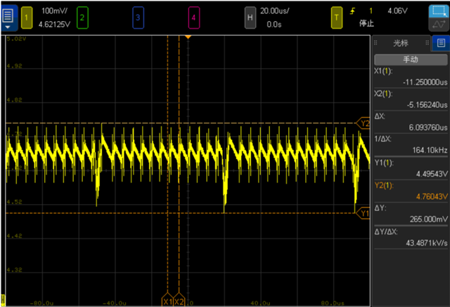

  • Iout : 50mA

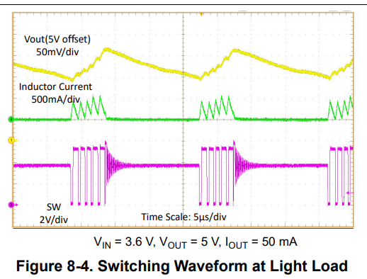

You can see that at the output there are peaks that can reach 265mV.
Can you suggest the resistances or capacitors to add, to reduce the noise under 50mv(As shown below)?
