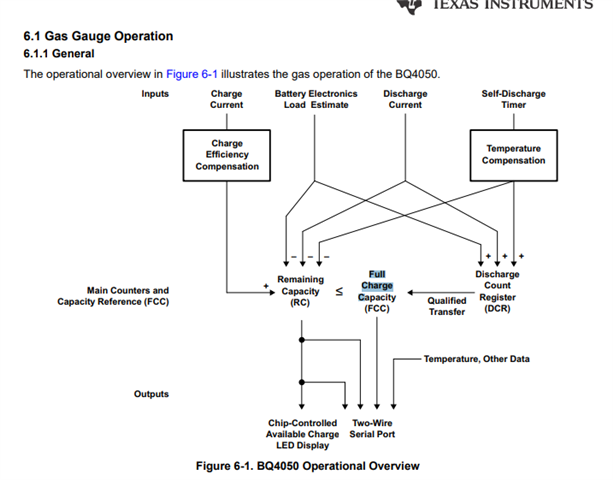

你好,现在有一个情况,BQ4050,批量中有些电池容量偏低,比如标6000mah的实际学习容量只有5000mah,那么如果Gas Gauging里面State里面的Learned Full Charge Capacity 填的6000(mAH)(多数电池在这个容量附近),那么充放一个循环后Full charge Capacity 变成5744mah,以后再循环多少次,还是5744,不再变化,Max Error 为8%。但是后面再怎么循环,也是改不过来,Full charge Capacity还是5744mah不变化。如果Learned Full Charge Capacity填的5000,则可以每次循环都更新不同的Full charge Capacity,比如5000,5080,5023…这样。这个问题有没有办法解决?

  • There is still some confusion on the wording of your question but I believe you are saying that you see a deviation of the real capacity of the cell and what the battery gauge tells you? What battery chemistry are you using some cell chemistry might need to have there own special chemID made? Also can you send a screenshot of the GPCCHEM report email to validate that you are using the proper chemID that has less than 3% error difference. The easiest solution would be to re run a calibration but this will likely not fix the issue.
  • 6000mAh lithium iron phosphate battery, using BQ4050, CEDV, According to the suggestion, impedance tracking is not used for lithium iron phosphate batteries. The following figure shows the "Full Charge Capacity" and "Max Error" values of different battery cells after cycling under different "Learned Full Charge Capacity" conditions. The green box represents the abnormal situation. According to the manual, if the learning capacity deviation exceeds the range of 256mah, the maximum update is limited to 256mah, but it will not be updated in the next cycle. It seems that the manual does not say so, but rather that each update is limited to 256mah, and after several updates, it reaches a value close to the true capacity. If it is a large capacity battery, it should be common for batch products to exceed 256mAh, right?

  • Understood, the battery issue has nothing to do with you. I just want to confirm that BQ4050 will update its' Full Charge Capacity 'once in this situation (with a capacity error exceeding 256mah), and will not update it again no matter what? Instead of updating multiple times to approach the actual capacity.
  • The BQ4050 has the ability to update the full charge capacity since it is able to see the real capacity from cell to cell. However with your amount of error difference from cell to cell of 256mAh than the user would have to be comfortable that the FCC especially in the start to be off by that amount but the accuracy should become better over time accounting that it doesn't have a harsh change in impedance as the cell ages.
