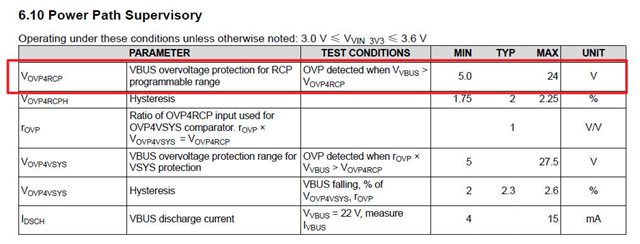

1.In datasheet 6.1, VBUS has an over - voltage protection function, and the range is from 5V to 24V. Is this range fixed? Can the threshold of over - voltage protection be set?

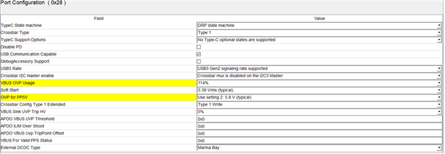

2.Users can set the voltage and current through ADCINx. For example, if the user sets the voltage range from 9V to 12V and the current range from 0A to 3A, and there is an external adapter that supports the PD protocol with output capabilities of 5V/3A, 9V/3A, 12V/3A, and 15V/3A, then what are the output voltage and current of PPHV after passing through the PD chip?
