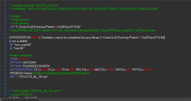

Hello
TPSI3113L-Q1 simulation error,Use the Ti official website model,The error information is as follows
Please help to see what the problem is, is it the problem of TPSI3113L-Q1 model?

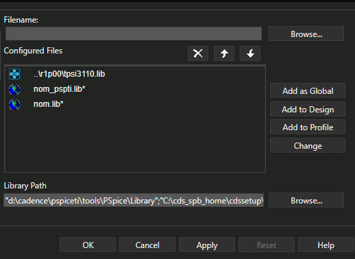

Hi
Thanks for reaching out to our team on E2E. I downloaded your project and needed to correct the reference to tpsi3110.lib in order for the project to simulate. Please set the filename to:
.\tpsi3113l.lib
