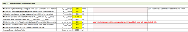

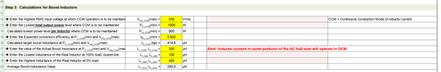

用UCC28070_Design_Tool_2.0计算,结果跟旧计算工具差很远,特别是升压电感和电流传感器复位电阻的值:
1、这个值怎么选择?
Enter the Lowest total output power level where CCM is to be maintained  的
PO_CCM(min) =
2、这值怎么那么大?旧软件算出来只有1K?
  Calculated minimum Reset Resistance (if resistor reset is used) RR (tgt) ≥  128.57
kΩ
