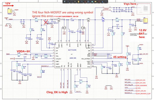

你好,我使用12V适配器连接到输入电压,使用当前电压为11.9V的锂电池连接到电池端,VSYS端连接到我的主电路,对MCU等器件供电。
问题是连接12V适配器后没有充电电流。
以下是我的原理图。

连接了12V适配器后,适配器的输出电流为零,表示bq25703A没有为电池充电。

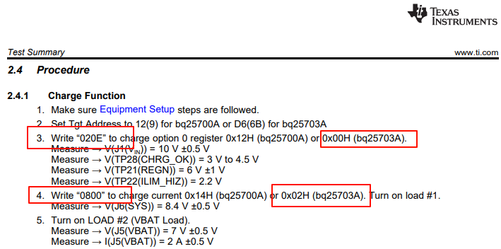

  • Please follow the user guide to start the charge function.
    User guide bq2570x Evaluation Module PDF|HTML 12 May 2016
  • I followed this, write 0x02 to 0x00h and 0x0E to 0x01h ;
    Then write the current to 0x02H;
    But it still can not charge.
    What else can I do ?
  • Hi,
    It is probably related to the way you write. The BQ2570X is programmed by a word format, while you write in a single byte.
    Try to change the sequence if any help. Big endian or little endian?

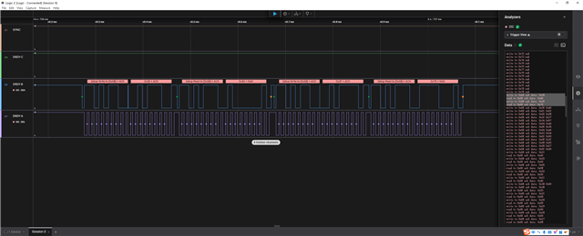

  • I set the I2C peripheral correctly. The following image shows the ManufacturerID(0x2E) is 0x40 and DeviceID(0x2F) is 0x78
    Then I write write 0x0E to 0x01h and  0x02 to 0x00h with MSB first format.
    The logic analyzer shows that the transmission finished correctly as follows.
    Here is some debug information if any help:

  • Somehow, still not conform to the datasheet protocols.
