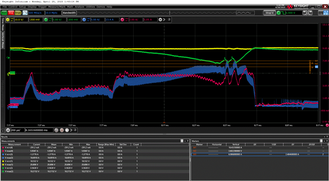

BQ25710  charger IC  in AC only mode (no Battery):
The system exhibits a Vsys rail voltage sag (dropping from 9V to 3.56V) during firmware loading in the boot process
Ch1(Yellow):  Vbus
Ch2(Green): Vsys
Ch3(Blue): Inductor Current
Ch4 (Red): Adapter Current  (100W adapter)
In the AC-only mode, is there any way to prevent my Vsys voltage from dropping when the system load increases? Additionally, in the AC-only mode, will Prochot not be triggered due to a decrease in Vsys voltage?

    从能源的角度来看,这是可以预料的。 当系统消耗的电流超过适配器所能提供的电流时,系统电压将会降低。 我的建议是使用PROCHOT通知CPU在引导过程中减少负载。 您可能需要将CELL_BATPRESZ针脚拉低电平以指示电池取出。

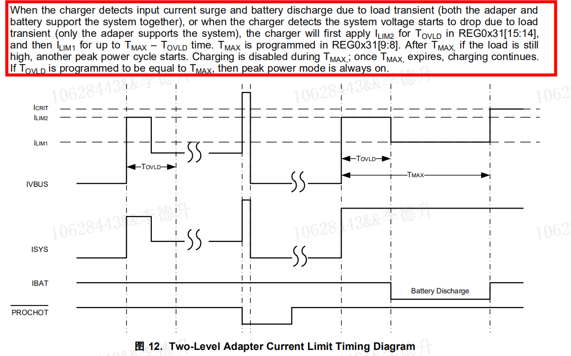

    2)Additionally, I have attempted to adjust the ‌Tmax value‌ to shorten the duration of the ‌Ilimt1 current limit‌ during high-load conditions, aiming to prevent ‌Vsys voltage drop‌. However, no improvement was observed. I also tried setting ‌Tovld = Tmax‌, allowing the adapter (Vbus) to handle transient high current during sudden load surges, thereby theoretically stabilizing Vsys. Is this logic correct? If yes, why did it fail to improve the situation? Theoretically, this should work.

    2.是的,您可以使用峰值功率模式来支持系统负载。或者,您可以提高电流限制(IINHOST)。我认为你不能让TOVLD=TMAX。确保在VSYS上启用PKPWR触发器(EN_PKPWR_VSYS=1和EN_IDPM=1)。

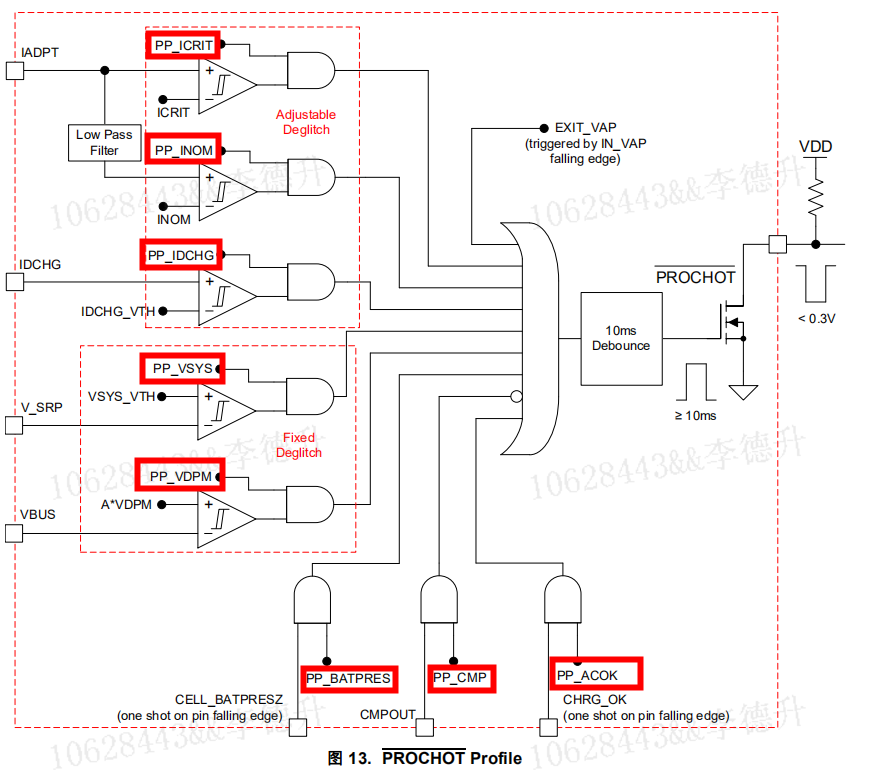

    3. Since we are currently using a 100W adapter, the IIN_HOST setting has already reached its limit. I attempted to use Peak Power Mode, but observed that after exceeding Tovld, the VBUS current is limited at the Ilimt1 level for the duration of Tmax minus Tovld, yet VSYS still drops significantly. Is there a Prochot trigger setting specifically for VSYS in Adapter-only mode? The datasheet mentions VSYS-related Prochot configurations, but these appear to target Battery-only mode. Does Prochot also trigger when VSYS drops in Adapter-only mode?
    4. Could you explain what the following terms in the diagram mean: PP_ICRIT, PP_INOM, PP_IDCHG, PP_VSYS, PP_VDPM, PP_BATPRES, PP_CMP, PP_ACOK? How are they defined? Additionally, what is the difference between PP_ICRIT and the "ICRIT" labeled in the diagram? If "ICRIT" is a configuration setting, what does "PP_ICRIT" represent?
