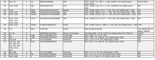

Hello,
I compared the ad table with the bom table,
Do these components still need to be installed on the OBC board?

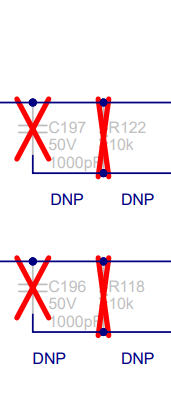

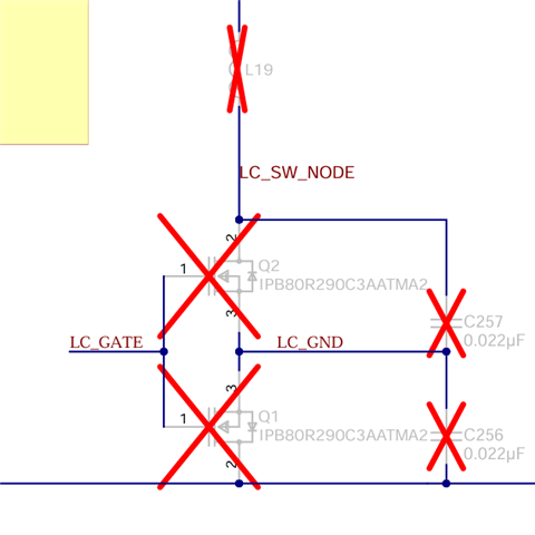

I don't understand what you mean. Can the circuit function be achieved without installing these components?
I am currently replicating this reference design. All the components are purchased according to the BOM list. As shown in the picture, I haven't purchased these components. Will this affect my circuit board? Can the circuit waveforms in the reference design be realized?
Hello,
You can please see the picture as follow, DNP=Do Not Place, not place is okay if you replicate the reference design.
