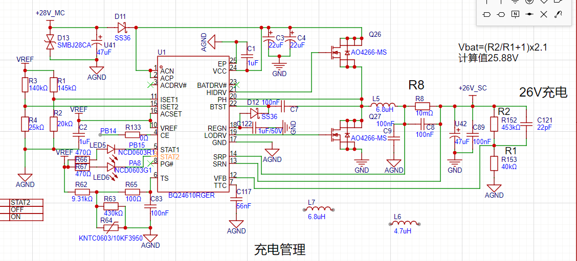

请问这个原理图有错吗?充电电流2A,充电电压25.88V,一接电池充电就烧毁MOS管和电感,芯片也烧毁。
0.014A,C1电容正负极短路,这是正常的吗?
No, Have you tried replacing this cap? Is the cap rated for high voltage?
