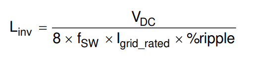

Could you explain the meaning of the number 8 in the denominator and how it is derived? I would like to know the detailed reasoning process. Also, what is the value of "%ripper"?

Hi,
I used this app note as a general reference for boost converter calculations.
plug Vo/vin = 1/(1-D) into equation 2 in the app note and you will get:
L = D(1-D)*Vo/(fs*ΔI)
D(1-D) term is the highest when D = 0.5. 0.5(1-0.5) = 0.25 or 1/4. this would give us the worst case or the min L we need:
L = Vo/(4*fs*ΔI)
But Vo = VDC/2 for the 3L t type converter in our case. Recall that the reference point for the boost is VDC/2.
L = VDC/(8*fsw*ΔI)
ΔI = Igrid_rated*%ripple
%ripple is a target ripple percentage that you would design for rule of thumb for the ripple current is 20 to 40% of the maximum inductor current.
