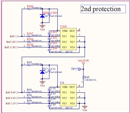

If we use BQ7718 to connect 6 series, is it possible?
Hi,
Please check the following parts for 6 series,
https://www.ti.com.cn/zh-cn/battery-management/protectors/products.html#1152min=6&
If you want to study the stacking of BQ7718, you can take a look at the schematic of TIDA-00108 to see if it can be referenced
https://www.ti.com.cn/tool/cn/TIDA-00108 www.ti.com.cn/.../tidrpq7
