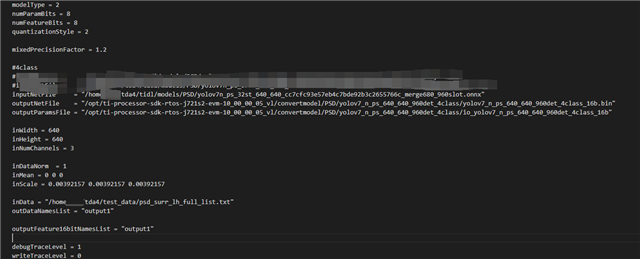

this is my config file for model convert:

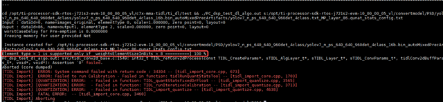

problem is:
if  i convert the model with parameter mixedPrecisionFactor = xx
then it would get the assert error

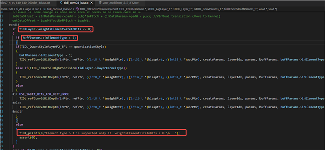

we found the src code for "PC_dsp_test_dl_algo.out"
you can see from our config file ,we did not set the "inElementType" so by your files said:
the default value should be 0
may be i think that because we set "mixedPrecisionFactor" so this  "inElementType" would be changed to other value
but we don't know how to avoid this error.
we need use "mixedPrecisionFactor" parameter for more efficiency inference frame rate  and higher accuracy inference result.
