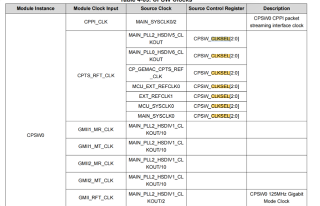

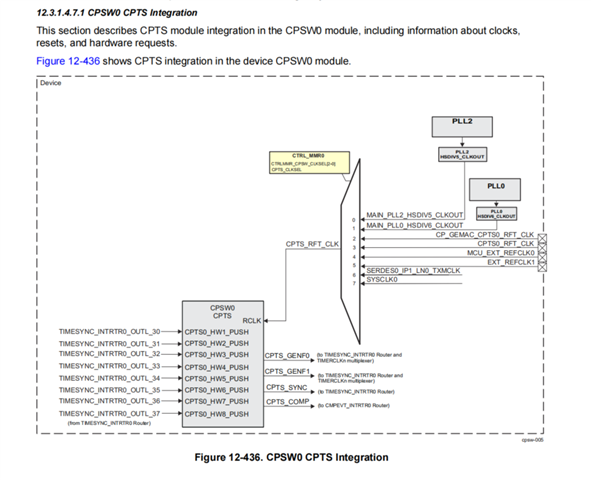

I would like to configure CPTS_RFT_CLK sourced from CP_GEMAC_CPTS0_RFT_CLK, and I have performed the following steps:
  1. I configured the general-purpose register 0x000F41F0 for the CP_GEMAC_CPTS0_RFT_CLK pin A18 with the value 0x08254006, enabling the input function and setting the pin mux to CP_GEMAC_CPTS0_RFT_CLK.
  2. Based on the requirements, I attempted to configure the CPTS_CLKSEL register to select CP_GEMAC_CPTS0_RFT_CLK as the input source. I also intend to feed in a clock signal ranging from 125MHz to 650MHz (I have an external PLL capable of outputting a sine wave within this frequency range).

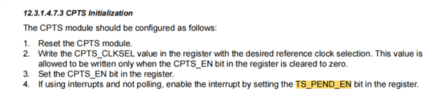

  3. I was unable to locate the following registers or fields in the documentation:
    • CPTS_CLKSEL
    • CPTS_EN
    • TS_PEND_EN
    • ADD_VAL[2-0]

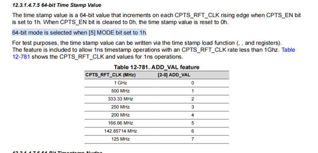

    • The MODE[5] bit which is mentioned in the phrase: “64-bit mode is selected when [5] MODE bit set to 1h”

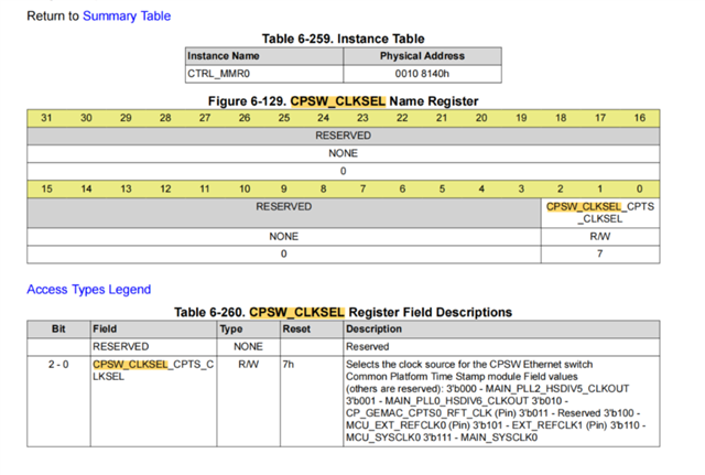

    I did find references that may correspond to these:
    • CPTS_CLKSEL might be CPSW_CKJSEL

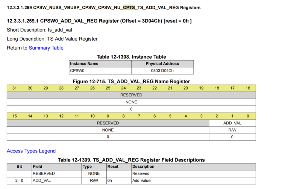

    • ADD_VAL[2-0] might correspond to CPSW_NUSS_VBUSP_CPSW_NU_CPTS_TS_ADD_VAL_REG
    However, I could not find clear documentation for the others. Could you please confirm their correct register names and locations?

  • Based on your latest response, it sounds like you have set up your Linux system to source the CPSW clock from an external source.
    Here are some additional tools that might be useful:
    CLOCKTREE-AM62X (the AM62x CLock tree tool - useful for visualizing clock paths in the system and how registers should be set to get specific clock settings): https://www.ti.com/tool/CLOCKTREETOOL
    Linux devicetree settings - clocks
    If we want to set the CPTS to have a parent clock of CP_GEMAC_CPTS0_RFT_CLK, I would expect you to modify the Linux tree like this:
    First, get the Device ID for the CPSW, and the Clock ID for the input clocks from the TISCI docs:
    https://software-dl.ti.com/tisci/esd/latest/5_soc_doc/am62x/clocks.html
    From that page:
    CPSW ID = 13.
    Input clock CPTS_RFT_CLK = 3
    Input parent clock to CPTS_RFT_CLK is CP_GEMAC_CPTS0_RFT_CLK = 6
