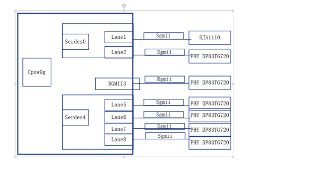

DRA829J: SGMII 5-8 interface not link in SDK9.2 for J721E
Part Number: DRA829J
1. we are using the TI DP83TG720 Ethernet PHY using the SGMII interface between the SOC and PHY
2. apply TDA4VM: SGMII interface not communicating with PHY(DP83TG720) in SDK9.2 for J721E - Processors forum - Processors - TI E2E support forums, eth1-eth6 can link up ; but only  lane2 sgmii can link, lane5 - lane8 sgmii can not link ;
3. some content in k3-j721e-common-proc-board.dts

&cpsw0 {
        status = "okay";
        pinctrl-names = "default";
        pinctrl-0 = <&main_mdio0_pins_default &main_rgmii2_pins_def
&cpsw9g_mdio {
        status = "okay";
        #address-cells = <1>;
        #size-cells = <0>;
        cpsw9g_phy0: ethernet-phy@4 {
        reg = <4>;
		cpsw9g_phy3: ethernet-phy@13 {
        reg = <13>;
		cpsw9g_phy5: ethernet-phy@5 {
        reg = <5>;
		cpsw9g_phy6: ethernet-phy@8 {
        reg = <8>;
		cpsw9g_phy7: ethernet-phy@10 {
        reg = <10>;
		cpsw9g_phy8: ethernet-phy@12 {
        reg = <12>;
&cpsw0_port1 {
	status = "disabled";
&cpsw0_port2 {
        status = "okay";
        phy-handle = <&cpsw9g_phy0>;
        phy-mode = "sgmii";
        mac-address = [00 00 00 00 00 00];
	    phys = <&cpsw0_phy_gmii_sel 2>, <&serdes0_sgmii_link>;
	    phy-names = "portmode", "serdes-phy";
&cpsw0_port3 {
	   status = "okay";
       phy-handle = <&cpsw9g_phy3>;
       phy-mode = "rgmii-id";
       phys = <&cpsw0_phy_gmii_sel 3>;
};  //rgmii
&cpsw0_port4 {
&cpsw0_port5 {
	   status = "okay";
       phy-handle = <&cpsw9g_phy5>;
       phy-mode = "sgmii";
       phys = <&cpsw0_phy_gmii_sel 5>, <&serdes4_sgmii_link>;
&cpsw0_port6 {
	   status = "okay";
       phy-handle = <&cpsw9g_phy6>;
       phy-mode = "sgmii";
       phys = <&cpsw0_phy_gmii_sel 6>, <&serdes4_sgmii_link>;
&cpsw0_port7 {
	   status = "okay";
       phy-handle = <&cpsw9g_phy7>;
       phy-mode = "sgmii";
       phys = <&cpsw0_phy_gmii_sel 7>, <&serdes4_sgmii_link>;
&cpsw0_port8 {
	   status = "okay";
       phy-handle = <&cpsw9g_phy8>;
       phy-mode = "sgmii";
       phys = <&cpsw0_phy_gmii_sel 8>, <&serdes4_sgmii_link>;

&serdes0 {
	status = "okay";
	assigned-clocks = <&serdes0 CDNS_SIERRA_PLL_CMNLC>,<&serdes0 CDNS_SIERRA_PLL_CMNLC1>;
	assigned-clock-parents = <&wiz0_pll1_refclk>,<&wiz0_pll1_refclk>;
	serdes0_pcie_link: phy@0 {
		reg = <0>;
        cdns,num-lanes = <1>;
        #phy-cells = <0>;
        cdns,phy-type = <PHY_TYPE_PCIE>;
        resets = <&serdes_wiz0 1>;
	serdes0_sgmii_link: phy@1 {
		reg = <1>;
		#phy-cells = <0>;
		cdns,phy-type = <PHY_TYPE_SGMII>;
		resets = <&serdes_wiz0 2>;
&serdes1 {
	assigned-clocks = <&serdes1 CDNS_SIERRA_PLL_CMNLC>;
	assigned-clock-parents = <&wiz1_pll1_refclk>;
	serdes1_pcie_link: phy@0 {
		reg = <0>;
		cdns,num-lanes = <2>;
		#phy-cells = <0>;
		resets = <&serdes_wiz1 1>, <&serdes_wiz1 2>;
&serdes2 {
	assigned-clocks = <&serdes2 CDNS_SIERRA_PLL_CMNLC>;
	assigned-clock-parents = <&wiz2_pll1_refclk>;
	serdes2_pcie_link: phy@0 {
		reg = <0>;
		#phy-cells = <0>;
		resets = <&serdes_wiz2 1>, <&serdes_wiz2 2>;
&serdes4 {
	status = "okay";
	assigned-clocks = <&serdes4 CDNS_SIERRA_PLL_CMNLC>;
    assigned-clock-parents = <&wiz4_pll0_refclk>;
	serdes4_sgmii_link: phy@0 {
		reg = <0>;
		cdns,num-lanes = <4>;
		#phy-cells = <0>;
		resets = <&serdes_wiz4 1>, <&serdes_wiz4 2>, <&serdes_wiz4 3>, <&serdes_wiz4 4>;

5. dmesg | grep eth
   0.000000] OF: reserved mem: initialized node vision-apps-r5f-virtual-eth-queues@e4000000, compatible id shared-dma-pool
[    0.000000] OF: reserved mem: initialized node vision-apps-r5f-virtual-eth-buffers@e4800000, compatible id shared-dma-pool
[    0.000000] psci: probing for conduit method from DT.
[    0.832840] optee: probing for conduit method.
[    2.312482] am65-cpsw-nuss 46000000.ethernet: initializing am65 cpsw nuss version 0x6BA00101, cpsw version 0x6BA80100 Ports: 2 quirks:00000000
[    2.325296] am65-cpsw-nuss 46000000.ethernet: initialized cpsw ale version 1.4
[    2.332501] am65-cpsw-nuss 46000000.ethernet: ALE Table size 64
[    2.342905] am65-cpsw-nuss 46000000.ethernet: CPTS ver 0x4e8a010a, freq:500000000, add_val:1 pps:1
[    3.787172] am65-cpsw-nuss c000000.ethernet: initializing am65 cpsw nuss version 0x6BA01901, cpsw version 0x6BA80101 Ports: 9 quirks:00000000
[    3.799961] am65-cpsw-nuss c000000.ethernet: Use random MAC address
[    3.806283] am65-cpsw-nuss c000000.ethernet: Use random MAC address
[    3.812595] am65-cpsw-nuss c000000.ethernet: Use random MAC address
[    3.818904] am65-cpsw-nuss c000000.ethernet: Use random MAC address
[    3.825211] am65-cpsw-nuss c000000.ethernet: Use random MAC address
[    3.831518] am65-cpsw-nuss c000000.ethernet: Use random MAC address
[    3.837777] am65-cpsw-nuss c000000.ethernet: initialized cpsw ale version 1.4
[    3.844895] am65-cpsw-nuss c000000.ethernet: ALE Table size 512
[    3.851235] am65-cpsw-nuss c000000.ethernet: CPTS ver 0x4e8a010a, freq:200000000, add_val:4 pps:0

6 ethtool eth4 (lane 5)

    2.  只有port6 的pll lock,但是依然所有sgmii无法link, 也不理解都是同样的设置,只有port6 的pll lock

    3. 请问还有哪里需要设置或者修改吗??
  • 您好,
         在这种情况下,0x0505E000的值是多少?现在时钟转储很好。
    这很奇怪。SGMII 5和SGMII 6的控制寄存器也不同。这不应发生,因为设备树节点是相同的,驱动程序应以相同的方式进行配置。
    您知道这里可能有什么区别吗?
  • 1. 0x0505E000的值依旧是0x000c0000
    2. 我配置上没有任何区别啊,硬件设计上也是完全一样的啊
  • 您好,
         请查看私信。
