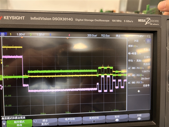

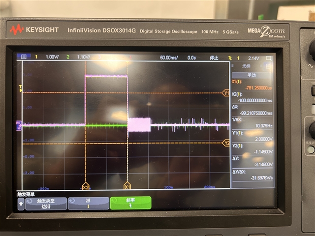

1)On the self-designed PCB the signal data for RBL drives USB in DFU boot mode is shown in the table below:
Time(us)
100000
150
1100
25
50
50
50
50
50
2.5
50
50
50
50
50
Voltage(v)
3
0
-0.5
0
-0.8
0.8
-0.8
0.8
-0.8
0.8
0.5
-0.5
0.5
-0.5
0.5
Note:There are a total of 1067 50us levels of data marked in red, alternating between high and low levels, with the last level being a high level.

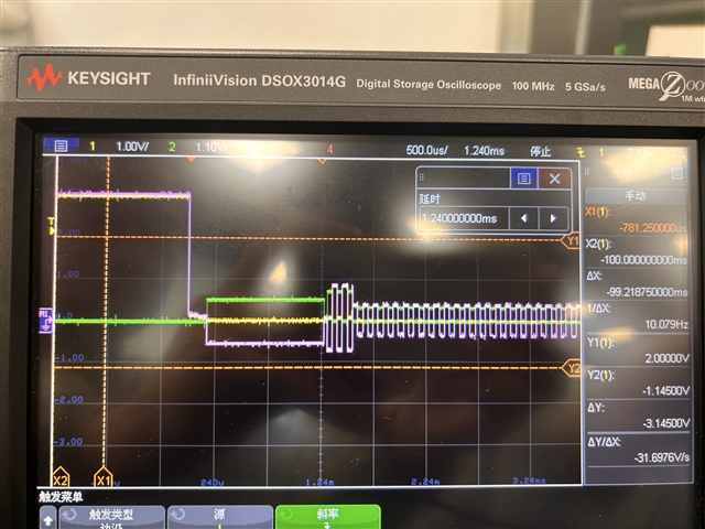

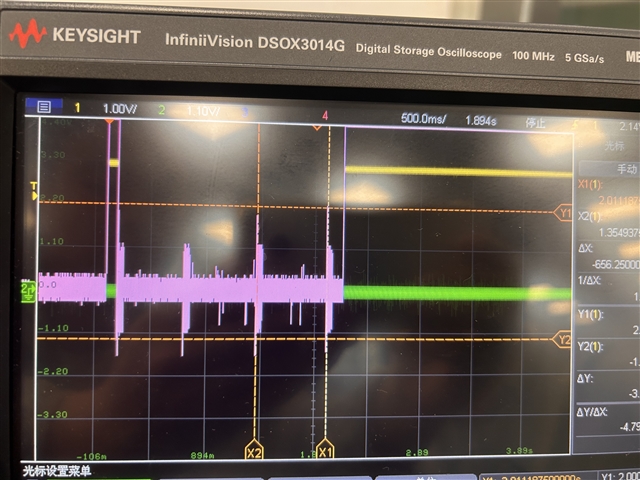

2)After the SD card boot starts, the USB signal is driven, and the signal content is as follows in 4 parts:
The first part of the signal is as follows.
Time(us)
100000
150
1100
25
50
50
50
50
50
2.5
50
50
50
50
50
Voltage(v)
3
0
-0.5
0
-0.8
0.8
-0.8
0.8
-0.8
0.8
0.5
-0.5
0.5
-0.5
0.5
The remaining 3 parts of the signal content are as follows:
Time(us)
500000
25
50
50
50
50
50
2.5
50
50
50
50
50
Voltage(v)
0
0
-0.8
0.8
-0.8
0.8
-0.8
0.8
0.5
-0.5
0.5
-0.5
0.5
Time(us)
500000
25
50
50
50
50
50
2.5
50
50
50
50
50
Voltage(v)
0
0
-0.8
0.8
-0.8
0.8
-0.8
0.8
0.5
-0.5
0.5
-0.5
0.5
Time(us)
500000
25
50
50
50
50
50
2.5
50
50
50
50
50
always
Voltage(v)
0
0
-0.8
0.8
-0.8
0.8
-0.8
0.8
0.5
-0.5
0.5
-0.5
0.5
3
Note:The part marked in red after each segment of the signal has 1067 levels of 50 microseconds, these levels alternate between high and low, ending with a high level.And the last signal part is a continuous high level of 3V.

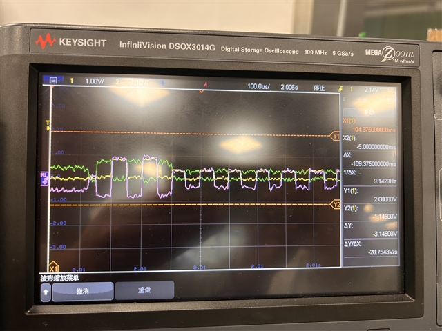

3)There is a significant difference in the signals on the AM6442-EVM evaluation board when successfully running the USB DFU function. Whether during the RBL phase driving the USB device as an AM64x DFU device or after the SBL driving the USB as an AM64x-AM243x DFUS device, the signals captured by the oscilloscope are the same, as shown below:
Time(us)
100000
150
1200
25
50
50
50
50
50
2.5
50
50
50
50
Voltage(v)
3
0
-0.5
0
-0.8
0.8
-0.8
0.8
-0.8
0.8
0.5
-0.5
0.5
-0.5
Note:In the red-highlighted part of the data, there are a total of 222 50us levels, alternating high and low levels, with the last level being low.

Overall diagram of the USB signal on the self-designed PCB board in SD card bootmode:
Detailed diagram of the USB signal on self-designed PCB board in SD card bootmode:
Overall diagram of the USB signal on the self-designed PCB board in DFU bootmode:
Detailed diagram of the USB signal on the self-designed PCB board in DFU bootmode:
Detailed diagram of the USB signal on the AM6442-EVM board in DFU bootmode:
