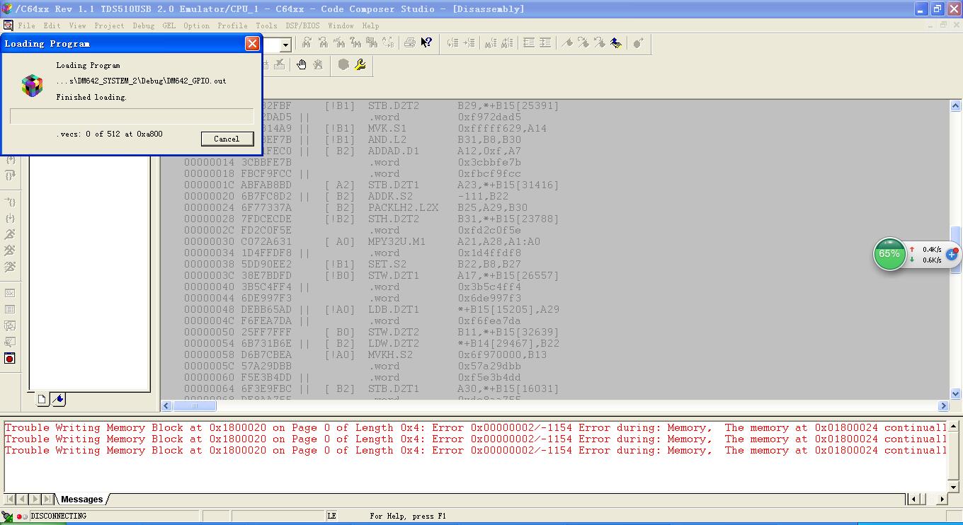

DM642新做的板子,与CCS3.3连上之后马上就断开
DM642新做的板子(只焊接了电源和DSP部分),与CCS3.3 connect之后马上就disconnect,错误信息如下:
Trouble Writing Memory Block at 0x1800020 on Page 0 of Length 0x4:
Error 0x00000022/-1154
Error during: Memory, Execution, The memory at 0x00000000 continually indicated it was 'not ready' The emulator was unable to regain control of the processor. The processor must be reset.
Sequence ID: 66
Error Code: -1154
Error Class: 0x00000022

  • 现在可以一直连上CCS,但是在load program时失败.
    .vecs:0 of 512 at 0xa800

    请检查一下map文件,看里面是否有使用到0x1800024这个地址?
  • map文件里我现在只保留了一条:
    GEL_MapAdd(0x00000000, 0, 0x00040000, 1, 1);        /* Internal Memory       */
    现在与CCS的连接没有问题,只是在load program时,会出现
    data verification failed at address 0x7FF0
