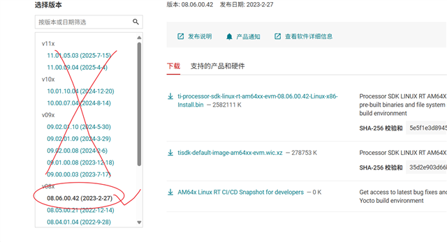

  • During further verification, it was found that the old version(08.06.00.42 (2023-2-27)) works properly, but new version all failed. What modifications are needed for the new kernel to achieve compatibility?
    sk-am64b SDK:PROCESSOR-SDK-LINUX-RT-AM64X 软件开发套件 (SDK) | 德州仪器 TI.com.cn

  • 1 yes , SK-AM64B PROC100A
    2 linuxptp works failed in sdk v11x,  linuxptp works ok in sdk 08x. now i use :v11.00.09.04
    4  linuxptp init failed, just as log:ptp4l[10551.342]: interface 'prp0' does not support requested timestamping mode
    failed to create a clock.
