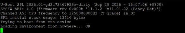

AM625: 以太网启动问题,通过以太网boot
Part Number: AM625
Other Parts Discussed in Thread: SK-AM62B-P1
1、我修改了Rules.make
# u-boot machine configs for A53 and R5
#UBOOT_MACHINE=am62x_evm_a53_defconfig
UBOOT_MACHINE=am62x_evm_a53_ethboot_defconfig
#UBOOT_MACHINE_R5=am62x_evm_r5_defconfig
UBOOT_MACHINE_R5=am62x_evm_r5_ethboot_defconfig
2、我配置了dhcpd,像说明一样
subnet 10.0.0.0 netmask 255.0.0.0
   range dynamic-bootp 10.0.0.2 10.0.0.16;
   if substring (option vendor-class-identifier, 0, 16) = "TI K3 Bootp Boot"
      filename "tiboot3.bin";
   } elsif substring (option vendor-class-identifier, 0, 19) = "AM62X U-Boot R5 SPL"
      filename "tispl.bin";
   } elsif substring (option vendor-class-identifier, 0, 20) = "AM62X U-Boot A53 SPL"
      filename "u-boot.img";
   range 10.0.0.17 10.0.0.25;
   default-lease-time 60000;
   max-lease-time 720000;
   next-server 10.0.0.1;
问题:网络启动不了,会卡在Loading Environment from nowhere... OK这句
图片为:
