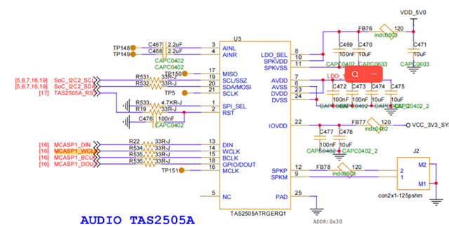

AM62A7: The sound of tas2505 is too loud and there is noise.
Part Number: AM62A7
Other Parts Discussed in Thread: TAS2505

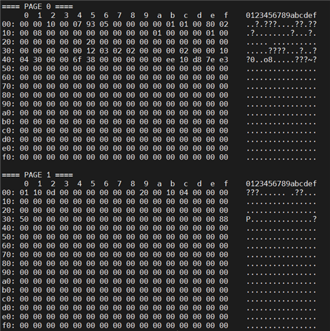

PAGE1
0x2E set 0x00
0x30 set 0x50
clk:
 ACLKX:5.670MHz
 AFSX: 44.13Khz
The device tree is set up as follows:

schematic diagram:
