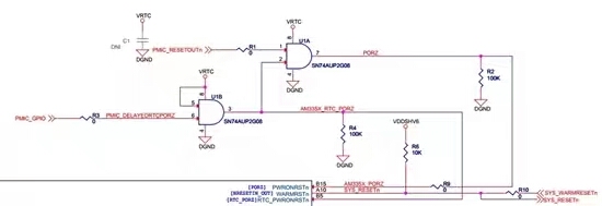

am335x的rtc_porz为什么要加与门,这和上电时序有什么关系
Other Parts Discussed in Thread: AM3359
TThe RTC_PORZ reset signal for the RTC section is derived using from an RC delay of the main power supply through VRTC power rail. An AND gate sharpens the edge to meet the AM3359 requirements.
