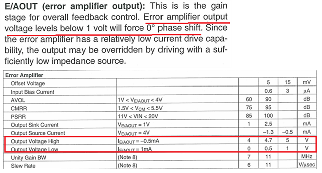

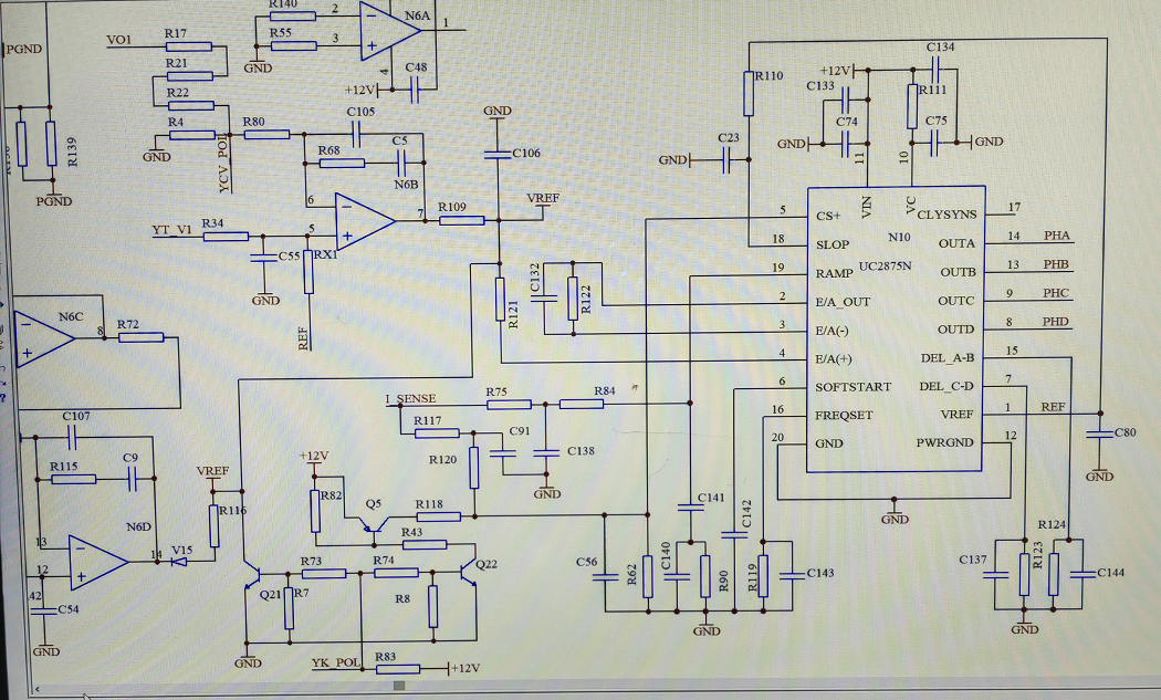

Dear  team
UC2875N, when the supply voltage exceeds 12.5V, the E/A OUT pin becomes 0.2V and the phase shift is fixed at 0 degreesCorner. PHA and PHC are in phase.
We would like to know if the above situation is normal.
