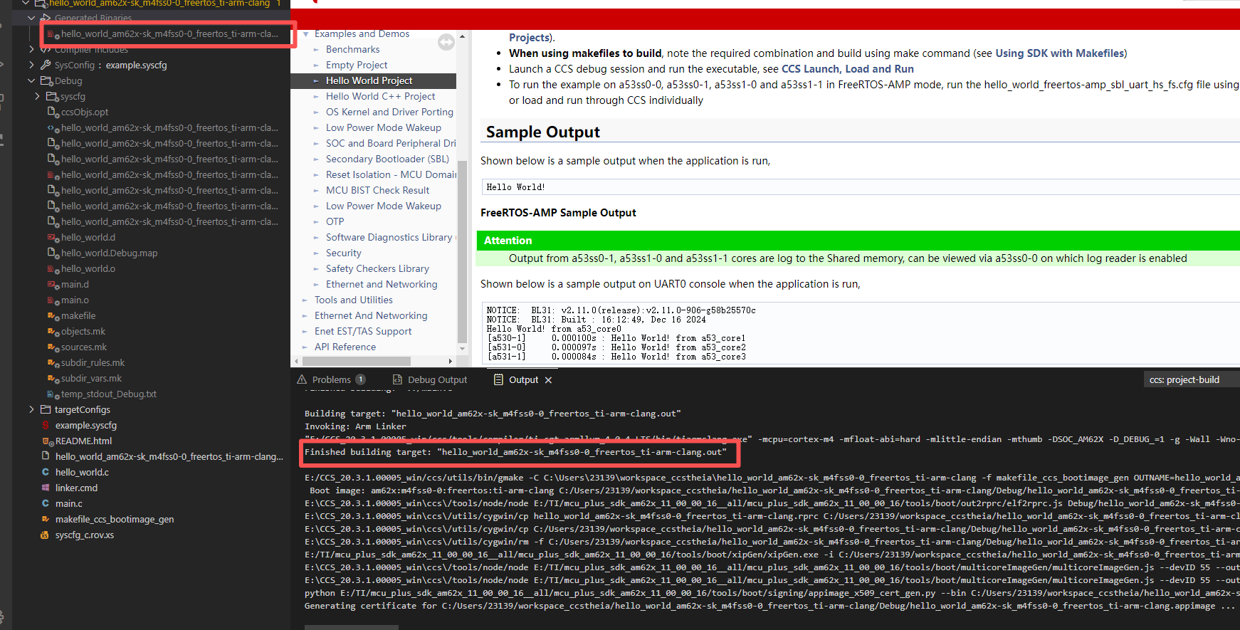

I compiled the "helloword" program for "am62x-sk_m4fss0-0_freeertos" using CCS. I intended to test the M core, but I encountered the "Invalid argument" error.

Is it because the firmware type is incorrect? Are there any other places that need to be revised?
/media/gyx/work/TI/example$ file ../mcu_example/hello_world_am62x-sk_m4fss0-0_freertos_ti-arm-clang.out
../mcu_example/hello_world_am62x-sk_m4fss0-0_freertos_ti-arm-clang.out: ELF 32-bit LSB executable, ARM, EABI5 version 1 (SYSV), statically linked, with debug_info, not stripped
