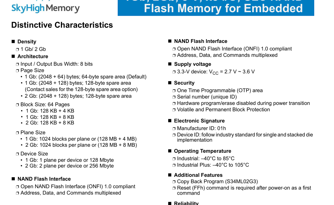

Part Number: AM3352
Hello, we replaced the NAND on our AM335X platform (now SkyHigh S34ML02G300TFI000, previously MT29F2G08ABAEAWP-IT:E). Booting from an SD card to flash the NAND works normally, but we cannot boot from the NAND itself. There is absolutely no output on the serial port. Is there a support limitation with the boot RAM?
OOB is 128 bytes
