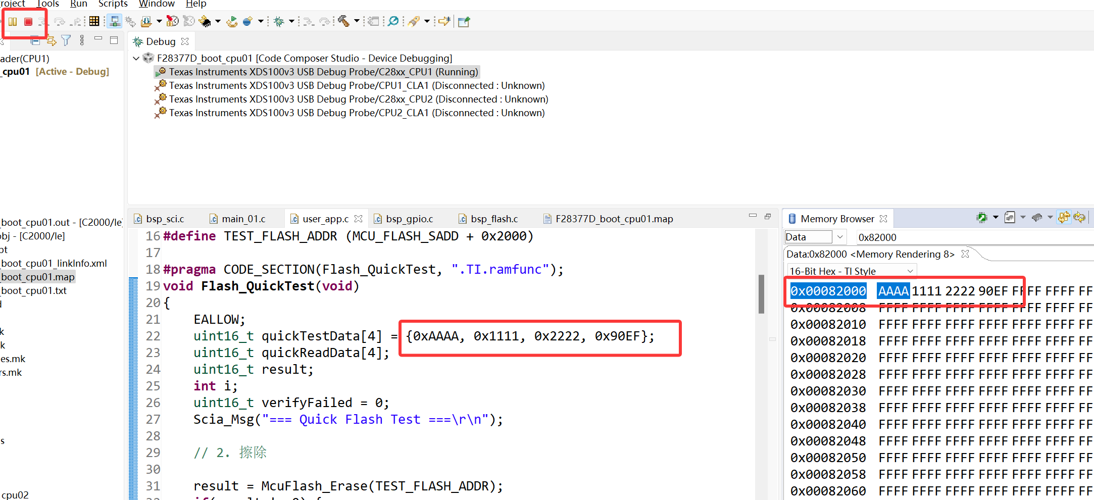

TMS320F28377D: F28377D移植官方flashapi,在线仿真测试正常,拔掉仿真器重新上电,程序执行到Fapi_issueProgrammingCommand就会跑飞,并且只能单独使用擦除函数,使用写入函数程序会跑飞,请问是什么问题
Part Number: TMS320F28377D
我在使用F28377D对flash进行写数据,在线仿真测试结果正常,能确保关于flash操作函数都已经搬到ram运行。
一、仿真操作
1:仿真操作前的情况:
2.仿真后的情况:
可以看到数据正常。

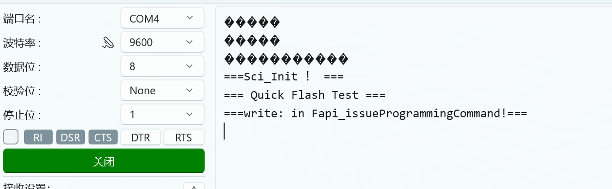

二、离线仿真情况
通过串口打印得出程序在执行 Fapi_issueProgrammingCommand后就跑飞了
定位代码如下:
附加我的flash代码

////////////////////////////////////////////配置flash///////////////////////////////////////////
 #pragma CODE_SECTION(McuFlash_Init, ".TI.ramfunc");
void McuFlash_Init(void)
    EALLOW;
 //   FlashRegs.FRDWAIT.bit.RWAIT = 5; // 对应 200 MHz EDIS;
    SeizeFlashPump();
//    DELAY_US(100);
    Flash0EccRegs.ECC_ENABLE.bit.ENABLE = 0;
//   DELAY_US(1000);
    Fapi_initializeAPI(F021_CPU0_BASE_ADDRESS, 200);
//    Fapi_writeEwaitValue(0x717);//时钟等待周期?
//    Fapi_flushPipeline();//刷新   测试失败
    Flash0CtrlRegs.FRD_INTF_CTRL.bit.PREFETCH_EN = 0;
    Fapi_setActiveFlashBank(Fapi_FlashBank0);
    Flash0CtrlRegs.FRD_INTF_CTRL.bit.PREFETCH_EN = 1;
    EDIS;
    ReleaseFlashPump();

 #pragma CODE_SECTION(McuFlash_Write, ".TI.ramfunc");
uint8 McuFlash_Write(uint32 Addr, const void *Data, uint32 Size)
    uint8 i;
    uint8 Res;
    Fapi_StatusType oReturnCheck;
    uint16 *Write = (uint16 *)Data;
    uint16 WriteBuf[MCU_FLASH_PB_SIZE];
    if (0 == Size || NULL == Data)
        return 1;
    if (Addr < MCU_FLASH_SADD || Addr + Size >= MCU_FLASH_SADD + MCU_FLASH_SIZE)
        return 1;
    if (Addr & (MCU_FLASH_PB_SIZE - 1))
        return 1;
    SeizeFlashPump();
    EALLOW;
    while (Size > 0) {
        if (Size >= MCU_FLASH_PB_SIZE) {
            for (i = 0; i < MCU_FLASH_PB_SIZE; i++)
                WriteBuf[i] = Write[i];
            Size -= MCU_FLASH_PB_SIZE;
        } else {
            for (i = 0; i < Size; i++)
            for (; i < MCU_FLASH_PB_SIZE; i++)
                WriteBuf[i] = 0xFFFF;
            Size -= Size;
        Scia_Msg("===write: in Fapi_issueProgrammingCommand!===\r\n");
        oReturnCheck = Fapi_issueProgrammingCommand((uint32 *)Addr, WriteBuf, MCU_FLASH_PB_SIZE, NULL , 0, Fapi_AutoEccGeneration);
        Scia_Msg("===write: out Fapi_issueProgrammingCommand!===\r\n");
        while (Fapi_checkFsmForReady() != Fapi_Status_FsmReady) {
        if (oReturnCheck != Fapi_Status_Success) {
            Res = 1;
//            goto FLS_SET_EXT;
        Addr += MCU_FLASH_PB_SIZE;
        Write += MCU_FLASH_PB_SIZE;
    Res = 0;
//    FLS_SET_EXT:
    EDIS;
    ReleaseFlashPump();
    Flash_claimPumpSemaphore(FLASHPUMPSEMAPHORE_BASE, (Flash_PumpOwnership)0);
    return Res;

#pragma CODE_SECTION(Flash_QuickTest, ".TI.ramfunc");
void Flash_QuickTest(void)
    EALLOW;
    uint16_t quickTestData[4] = {0xAAAA, 0x1111, 0x2222, 0x90EF};
    uint16_t quickReadData[4];
    uint16_t result;
    int i;
    uint16_t verifyFailed = 0;
    Scia_Msg("=== Quick Flash Test ===\r\n");
    // 2. 擦除
    result = McuFlash_Erase(TEST_FLASH_ADDR);
    if(result != 0) {
        Scia_Msg("Erase FAILED!\r\n");
        return;
/*    result = McuFlash_Read(TEST_FLASH_ADDR, quickReadData, sizeof(quickReadData));
    if(result != 0) {
        Scia_Msg("Read FAILED!\r\n");
        return;
    // 3. 写入
    result = McuFlash_Write(TEST_FLASH_ADDR, quickTestData, sizeof(quickTestData));
    if(result != 0) {
        Scia_Msg("Write FAILED!\r\n");
        return;
    // 4. 读取
    if(result != 0) {
        return;
    // 5. 验证
    for( i = 0; i < 4; i++) {
        if(quickTestData[i] != quickReadData[i]) {
            Scia_Msg("Verify FAILED at pos \r\n");
            Scia_Xmit('0' + i);
            Scia_Msg("\r\n");
            verifyFailed = 1;
    if(!verifyFailed) {
        Scia_Msg("PASS - Quick Test OK!\r\n");
    EDIS;
