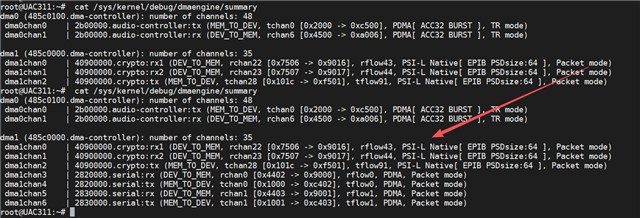

When running Linux-RT on AM62x and using serial port programming in the Linux system, there is a time gap of more than ten microseconds between bytes when sending data, which causes abnormalities in the receiving slave device. I have attached part of my application code in the hope that my issue can receive technical support

As shown in the figure, I have extracted one of the data points where a significant gap appears between the second and third bytes. This phenomenon may occur randomly several times within hundreds of data frames. Furthermore, this issue becomes more frequent when Linux is running a large number of file stream operations, leading to high load on the am62x.
