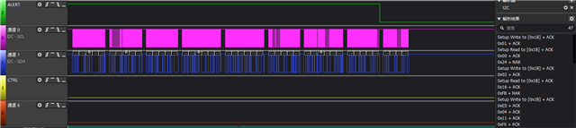

默认loop=1,我尝试写入VOU_MAX=0x011A,VOUT_MIN= 0X0300,这时候应该产生警告。为什么我测的警告引脚一直是低电平?

您向触发的输出过压保护是吧,
7.6.20 VOUT_OV_FAULT_RESPONSE (41h) The VOUT_OV_FAULT_RESPONSE command instructs the device on what action to take in response to an Output Over Voltage Fault based on MFR_SPECIFIC_07 (PCT_OV_UV_WRN_FLT_LIMITS). The device also: • Sets the OVF bit in the STATUS_BYTE • Sets the VFW bit in the STATUS_WORD • Sets the OVF bit in the STATUS_VOUT register, and • Notifies the host by asserting SMBALERT For loop slave device, this command cannot be accessed. Any writes to this command will be ignored. An attempt to read or write this command will result in a NACK’d command, the reporting of an IVC fault, and triggering of SMB_ALERT. The contents of this register can be stored to nonvolatile memory using the STORE_DEFAULT_ALL command
请datasheet这部分来进行触发。

您好
请检查您的ON_OFF_CONFIG (02h) 、OPERATION (01h) 这两个寄存器是否满足datasheet的说明,或者检查CNTL脚电压情况。

您好
7.6.2 ON_OFF_CONFIG (02h)
https://www.ti.com/lit/ds/symlink/tps546c23.pdf
datasheet中这一页的说明请按照这个搭配01H进行配置,根据您的需求统一一下控制指令再进行尝试调整。
