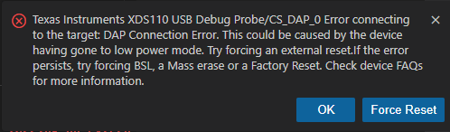

     I am using CCS v20.5 and developing with mspm0_sdk_2_10_00_04.Then I compiled and flashed the lin_responder demo project, and the sample's behavior was as expected.
     This project entered low power mode and only wakes up when an interrupt occurs. So now I can't flash the sample anymore, and it shows CS_DAP_0: Error connecting to the target: DAP Connection Error. This could be caused by the device having gone to low power mode. Try forcing an external reset. If the error persists, try forcing BSL, a Mass erase, or a Factory Reset. Check device FAQs for more information.
     I also referred to other posts and used CCS's factory reset function. But no matter how I press the NRST and the PA18 button on the left, it doesn’t work.
     In addition, only the USB is connected on the development board, and all the J101 jumpers are connected.

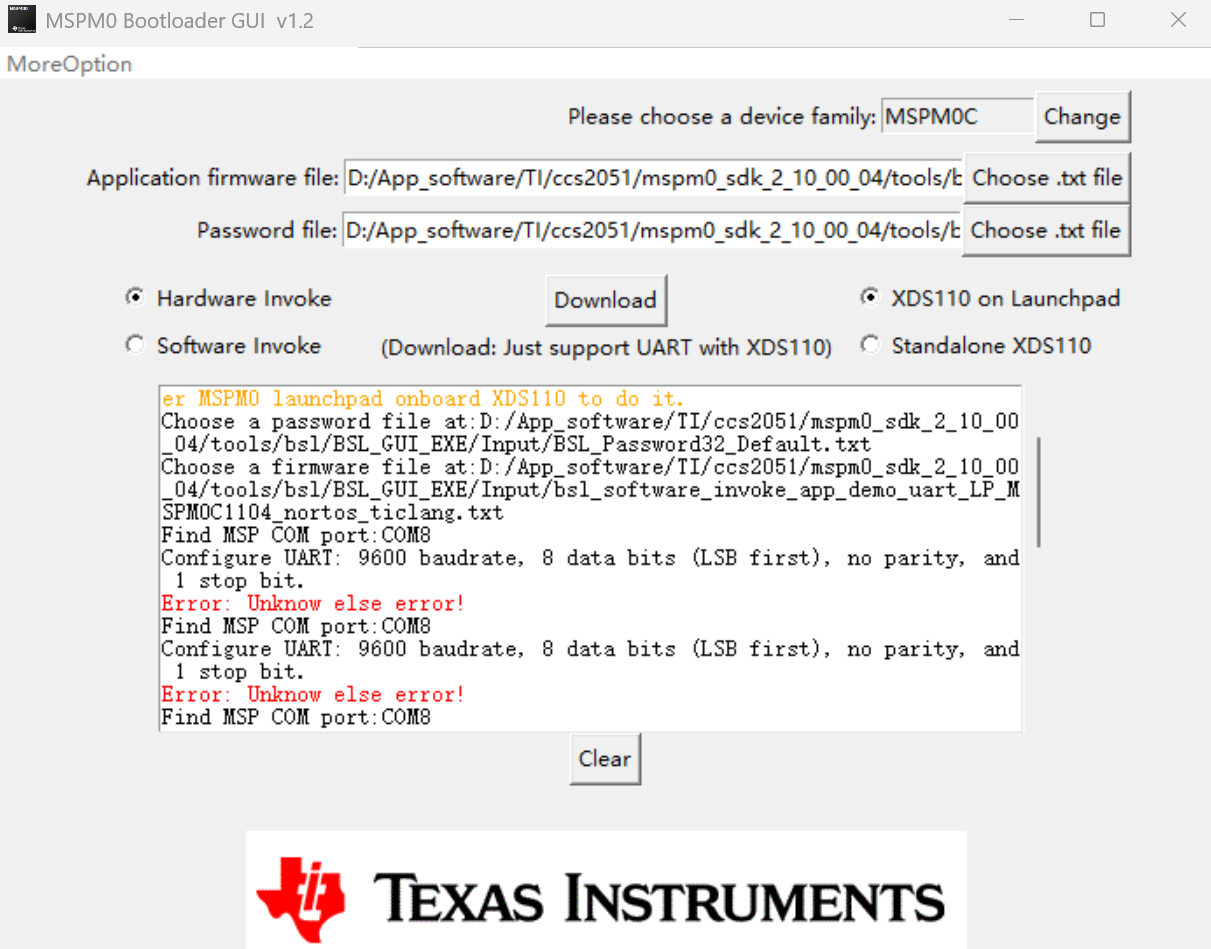

I also use MSPM0 Bootloader GUI v1.2, and still cannot connect.
The password uses BSL_Password32_Default.txt from the SDK. The application firmware did not find M0C1106, so I chose bsl_software_invoke_app_demo_uart_LP_MSPM0C1104_nortos_ticlang.txt from the SDK.
     Is there a problem with my connection operation? Are there any other connection methods???
