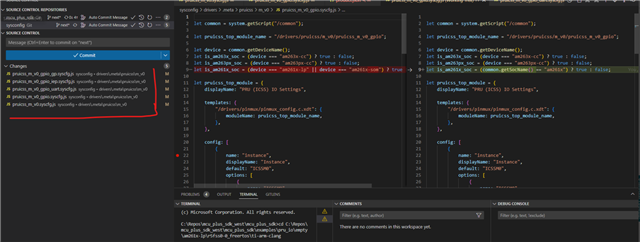

AM2612: 官方参考工程endat_diagnostic_single_channel,里面用的CFG的,但是我想用ZCZ ZEJ ZNC来做,
Part Number: AM2612
可是修改封装后sysconfig老提示如下错误,能否提供一下其余封装的工程,建议能出一套详细的SDK教程,本来处理器很不错,但是在PRU-ICSS怎么分配ENDAT2.2及ETHERCAT的管脚过程中,太难了,特别容易出错,能否给弄一个简单教程。针对不同的串行编码器协议,和工业总线怎么安全正确的分配管脚,大家首先就被这个弄的迷迷糊糊的,也就不乐意选择这个处理器了。详细弄一个简明易懂的PRU-ICSS的应用教程。

  • Hi Lzg,
    There is an issue in motor control sdk and mcu plus sdk with AM261x device detection.
    Here's the fix:
    Replace device detection in these files:
    MCU Plus SDK:
    - source/drivers/.meta/pruicss/m_v0/ (similar files)
    Similar changes need to be made for the Motor Control SDK as well. I am sharing the updated files for the Endat example:
    • motor_control_sdk\source\.meta\position_sense\endat\am26x_pins.js
    • motor_control_sdk\source/.meta/position_sense/endat.syscfg.js

    This will resolve the error you are encountering with the Endat example.
    Similar changes will be required for other modules like Tamagawa/BiSS-C if you use those modules.
    **Change:**
    Replace `common.getDeviceName()` with:'common.getSocName()` and use "am261x" for check
    ```javascript
    let is_am261x_soc = (common.getSocName() == "am261x") ? true : false;
    let device = is_am261x_soc ? common.getSocName() : common.getDeviceName();
