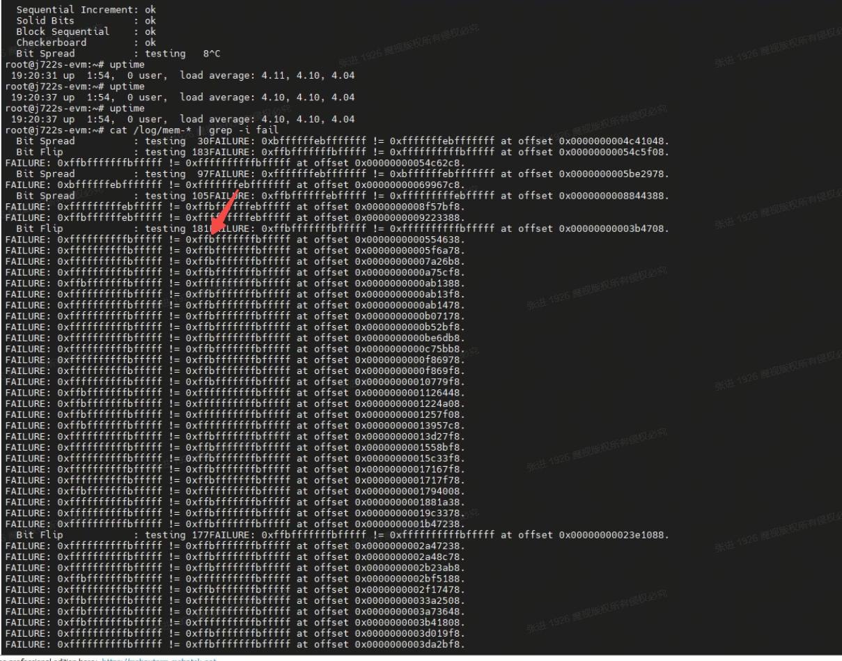

When we were conducting DDR Memory test, we found that there were fixed bit errors. Could you please help analyze the possible reasons .
Best Regards!
It could be a damaged chip or bad soldering, try testing a few more chips.
TI has soldering requirements for the chip, see the document below
