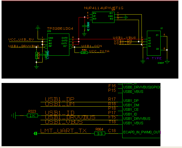

AM3352板子 usb调试问题请教,谢谢
自研板子
usb电路部分参考的TI的demo板(具体电路如附件1)

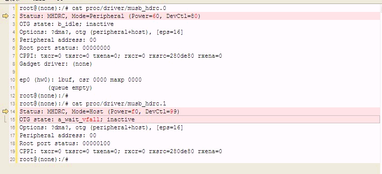

初始化log如附件2
现在的问题是 插上U盘后板子无反应,查询proc/interrupts下的 USBINT1( irq 19)计数一直为1不变
setup_pin_mux(usb1_pin_mux)及menuconfig等已经配置
还请TI的高手帮忙指点下思路,谢谢!

root@(none):/# cat proc/interrupts
CPU0
4: 0 INTC omap2_elm
12: 20 INTC edma
14: 0 INTC edma_error
16: 0 INTC tiadc
18: 0 INTC musb-hdrc.0
19: 1 INTC musb-hdrc.1
20: 0 INTC pruss_evt0
21: 0 INTC pruss_evt1
22: 0 INTC pruss_evt2
23: 0 INTC pruss_evt3
24: 0 INTC pruss_evt4
25: 0 INTC pruss_evt5
26: 0 INTC pruss_evt6
27: 0 INTC pruss_evt7
40: 0 INTC cpsw
43: 0 INTC cpsw
44: 129 INTC OMAP UART3
68: 3202 INTC gp timer
70: 0 INTC omap_i2c
77: 0 INTC wkup_m3
