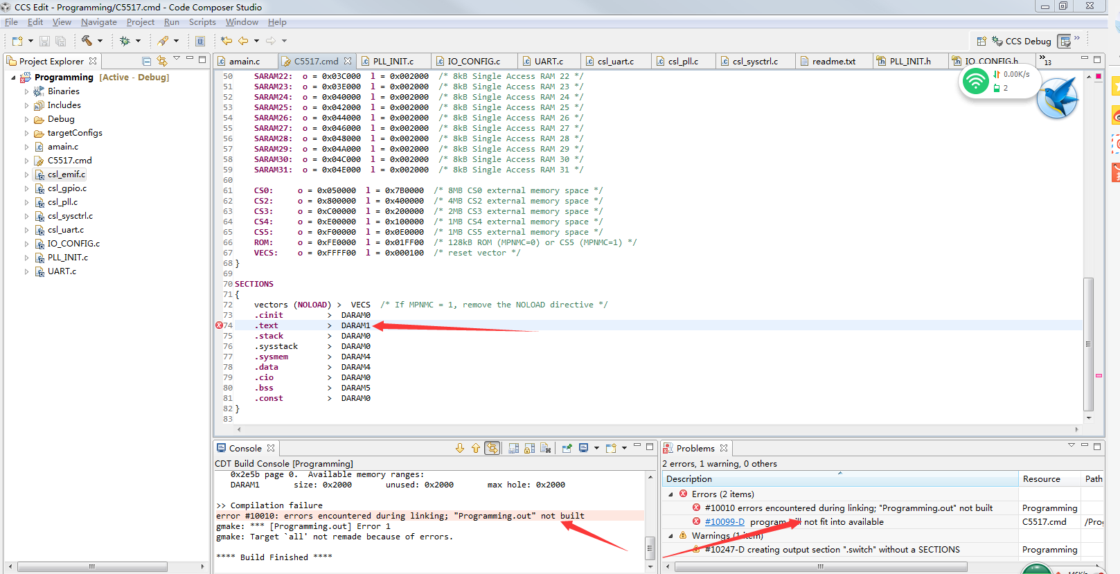

c5517中 添加官方库emif.c文件就出现错!
Expert 2137 points
specification
"../C5517.cmd", line 74: error #10099-D: program will not fit into available
memory. placement with alignment/blocking fails for section ".text" size
0x2e5b page 0. Available memory ranges:
DARAM1 size: 0x2000 unused: 0x2000 max hole: 0x2000
>> Compilation failure
error #10010: errors encountered during linking; "Programming.out" not built
gmake: *** [Programming.out] Error 1
gmake: Target `all' not remade because of errors.
