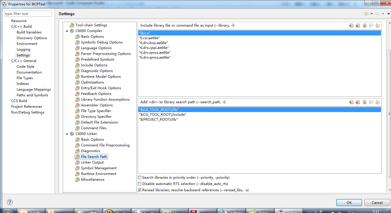

采用TCI6618 Device cycle approximate Simulator Big Endian找不到文件
采用TCI6618 Device cycle approximate  Simulator Big Endian,在load program一直处于running状态,停下来后出现下面打印:
Can't find a source file at "/sim/sds12/scratch/tsuch_rtsbuild_dflcmp2507.dal.design.ti.com_23248_linux/c60_rts/SHARED/copy_decompress_rle.c"
Locate the file or edit the source lookup path to include its location.
但是我采用TCI6618 Device Function Simulator Big Endian没有此问题,我需要用到FFTC,TCP3D以及BCP
附件是我link文件的配置。下面是我cmd的配置,盼望解答,多谢!
-x
-stack 0x2000
-heap 0xa000
