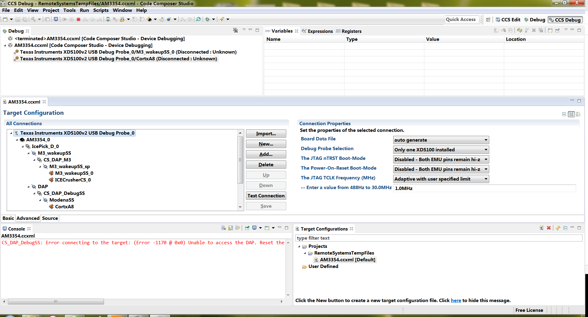

     试了很多类似AM335x的.gel文件,但是都不能链接成功。出现
Error connecting to the target:
(Error -1170 @ 0x0)
Unable to access the DAP. Reset the device, and retry the operation. If error persists, confirm configuration, power-cycle the board, and/or try more reliable JTAG settings (e.g. lower TCLK).
(Emulation package 6.0.407.3)
JTAG连接没问题!
  时钟配置看下图(1MHZ)
之前也试过论坛上的排至.gel文件,但是均不成功,应该还是.gel文件本身的错误。
