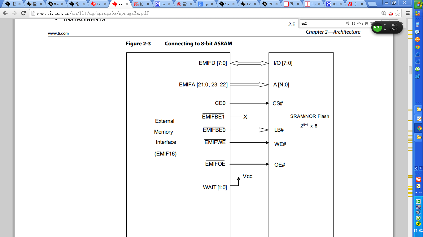

1 电源时钟设计照搬EVM板,FPGA换成Xilinx V6系列一款
2 6678 boot设计,EMIF16外接sst39vf800A(x16) +I2C EEPROM, 设计意图:使用EMIF16NORflash加载,I2C EEPROM做为备用加载方式
3 DDR3芯片把卡发板中的4片2G换成同系列的4G版本,K4B4G1446,去掉用做ECCDDR3芯片
4 一路x2的SRIO与FPGA相连,x2的PCIe通过PCIe SWITCH连到计算机
对照硬件设计手册确认满足各个外设的设计要求即可。初步来看问题不大,注意外接DDR3芯片的要求如下:
DDR3外接RAM要求:
• 72-bit: Five 16-bit SDRAMs (including 8 bits of ECC)
• 72-bit: Nine 8-bit SDRAMs (including 8 bits of ECC)
• 36-bit: Three 16-bit SDRAMs (including 4 bits of ECC)
• 36-bit: Five 8-bit SDRAMs (including 4 bits of ECC)
• 64-bit: Four 16-bit SDRAMs
• 64-bit: Eight 8-bit SDRAMs
• 32-bit: Two 16-bit SDRAMs
• 32-bit: Four 8-bit SDRAMs
• 16-bit: One 16-bit SDRAM
• 16-bit: Two 8-bit SDRAM
