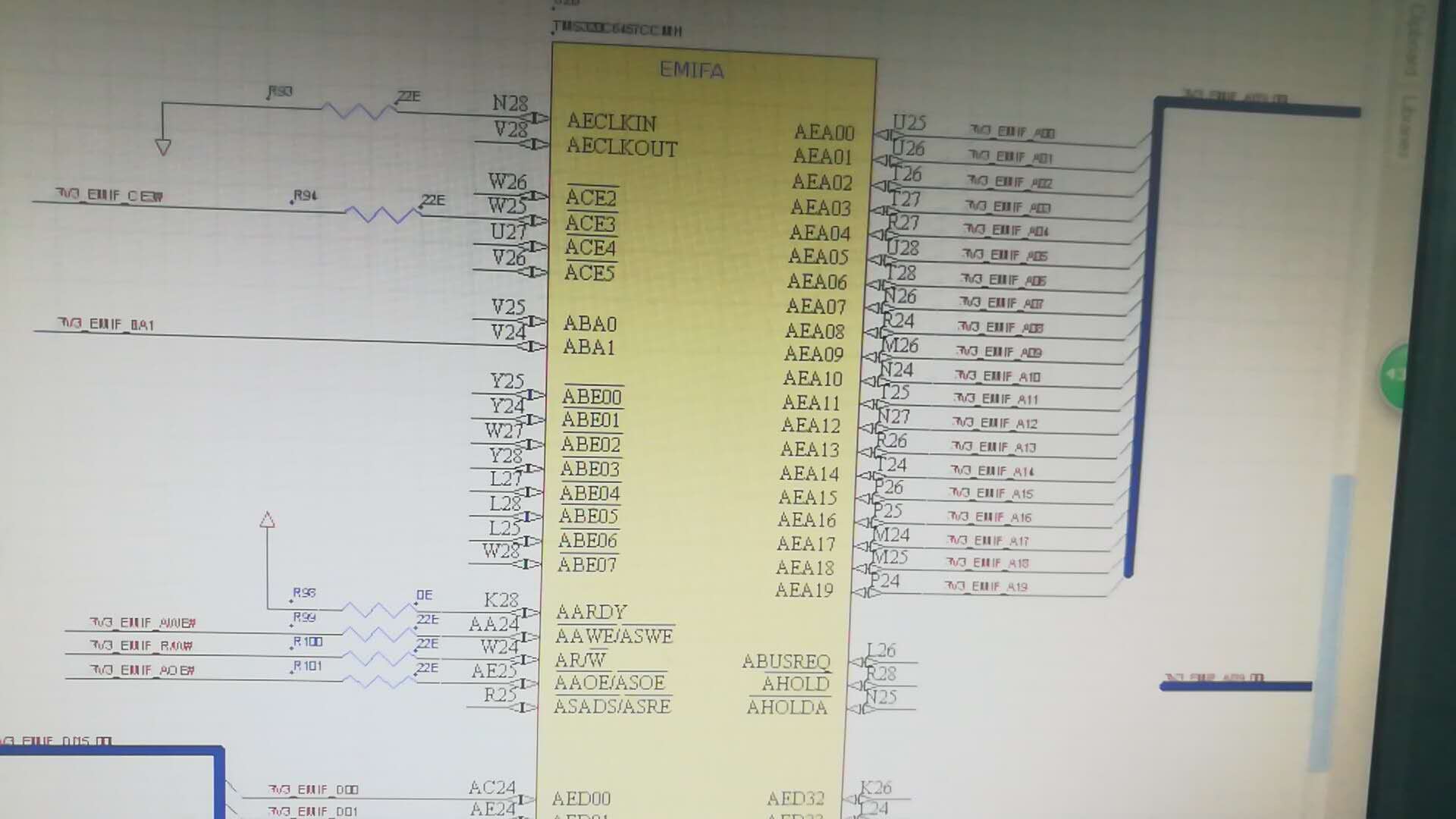

C6457通过EMIFA连接FLASH,参照CSI驱动例程,修改相关配置参数,
#define CSL_EMIFA_ASYNCWAIT_DEFAULTS {\
(CSL_EmifaArdyPol)CSL_EMIFA_ARDYPOL_LOW, \
(Uint8)CSL_EMIFA_ASYNCWAIT_MAXEXTWAIT_DEFAULT, \
(Uint8)CSL_EMIFA_ASYNCWAIT_TURNARND_DEFAULT \
/** The default values of EMIFA CEConfig for Async structure */
#define CSL_EMIFA_ASYNCCFG_SELECTSTROBE_DEFAULT 0x00
#define CSL_EMIFA_ASYNCCFG_WEMODE_DEFAULT 0x00
#define CSL_EMIFA_ASYNCCFG_ASYNCRDYEN_DEFAULT 0x00
#define CSL_EMIFA_ASYNCCFG_WSETUP_DEFAULT 0x0F
#define CSL_EMIFA_ASYNCCFG_SSTROBE_DEFAULT 0x3F
#define CSL_EMIFA_ASYNCCFG_WHOLD_DEFAULT 0x07
#define CSL_EMIFA_ASYNCCFG_RSETUP_DEFAULT 0x0F
#define CSL_EMIFA_ASYNCCFG_RSTROBE_DEFAULT 0x3F
#define CSL_EMIFA_ASYNCCFG_RHOLD_DEFAULT 0x07
#define CSL_EMIFA_ASYNCCFG_ASIZE_DEFAULT 0x01
hwSetup.ceCfg[0] = NULL;
hwSetup.ceCfg[1] = &asyncVal;
hwSetup.ceCfg[2] = NULL;
hwSetup.ceCfg[3] = NULL;

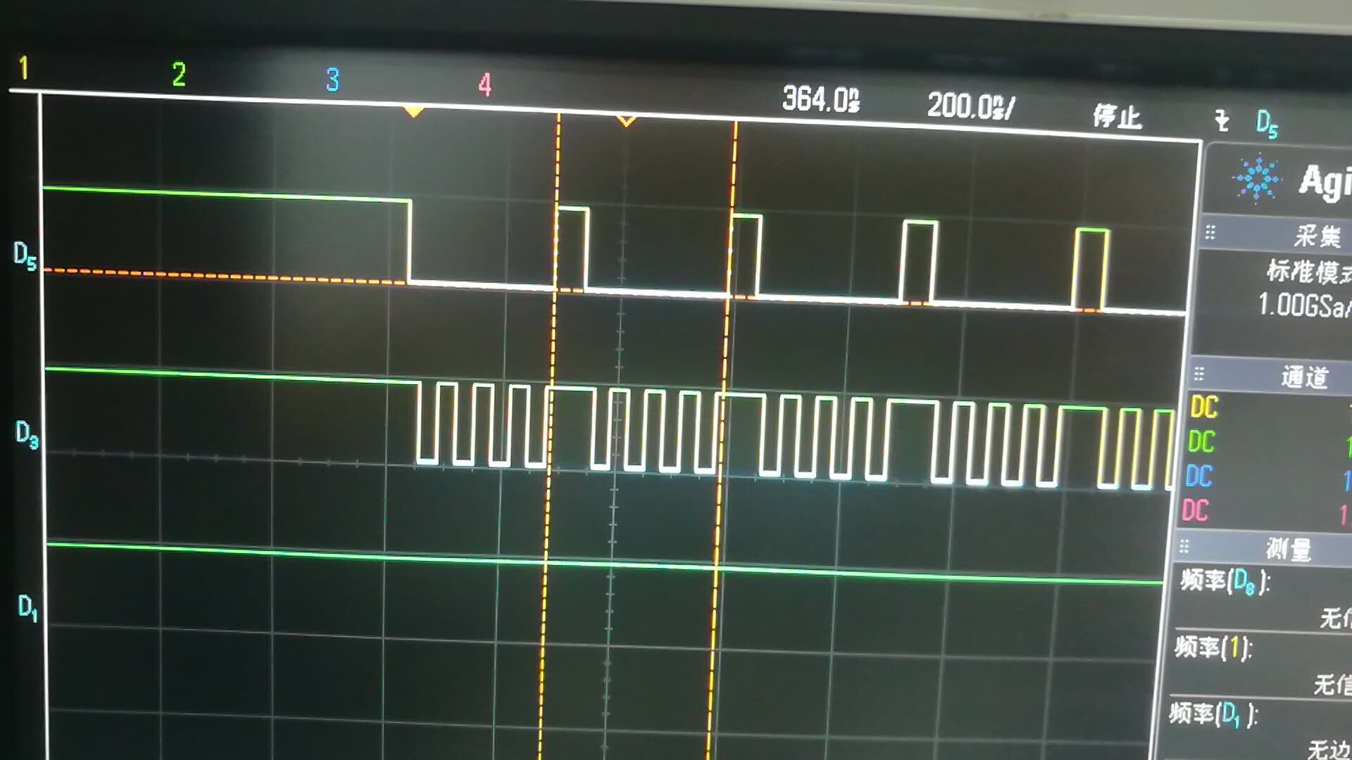

无法进入写状态,, 比如:pAsyncData[index] = tempData; (pAsyncData 地址为0xb0000000) , 通过仿真调试, 示波器观察如图:
D5为CE3 , D3为AOE  D1为AWE。

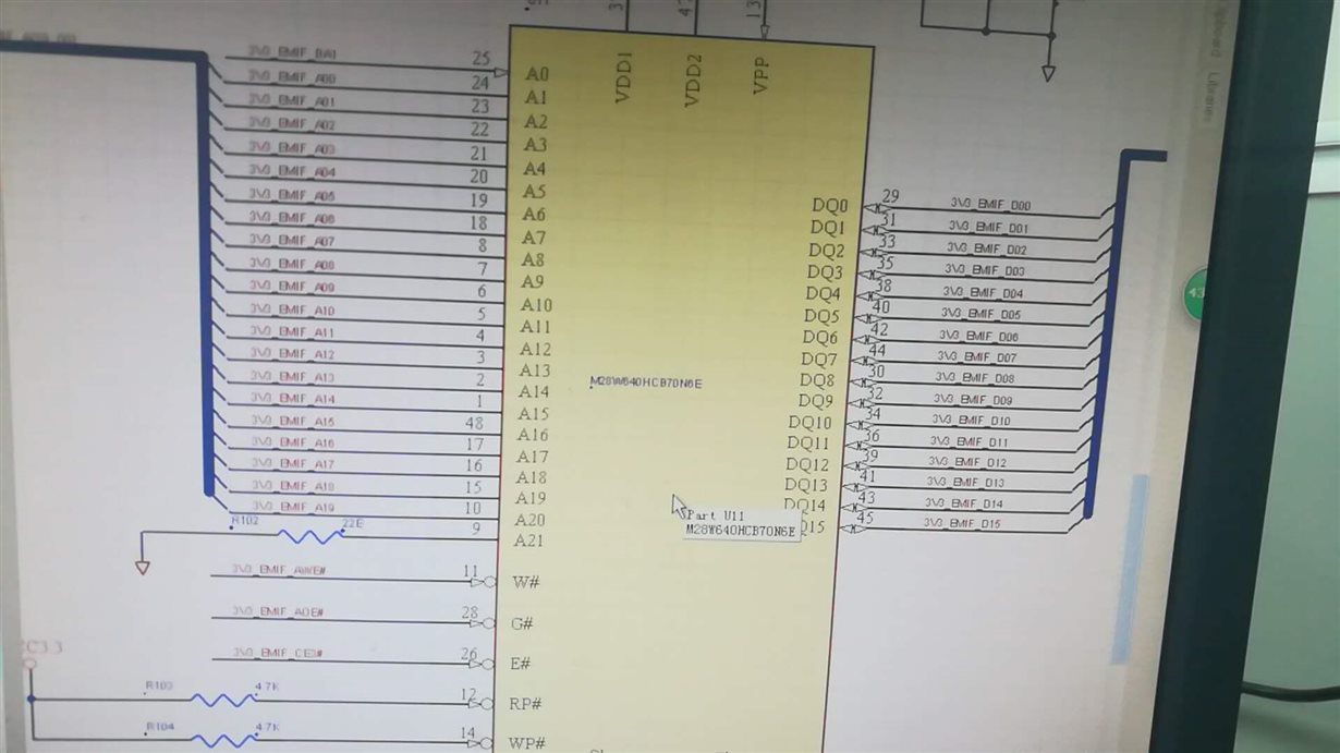

电路图如下:
