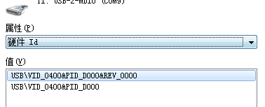

I try to install how  DP83TC811EVM-CDC-Driver Software,but failed.
I modified vid and pid as suggested but the following problem.

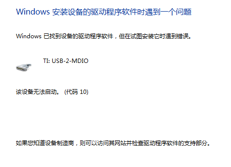

Open setupapi.dev.log, there are a total of 3 errors!
1)INF hash is not present in the catalog. Driver package appears to be tampered. Filename = C:\Windows\System32\DriverStore\Temp\{5c136ea6-7e21-6c16-686b-a32fcb1e9504}\msp430_ti_signed.inf, Error = 0xE000024B
!    sto:                          Driver package appears to be tampered but user wants to install it anyway.
2) FilePath = C:\Windows\System32\DriverStore\FileRepository\msp430_ti_signed.inf_amd64_neutral_848d249cd1e164c9\msp430_ti_signed.inf
     sig:           Catalog  = C:\Windows\System32\DriverStore\FileRepository\msp430_ti_signed.inf_amd64_neutral_848d249cd1e164c9\MSP430_CDC.cat
!    sig:           Verifying file against specific (valid) catalog failed! (0x80096002)
3) FilePath = C:\Windows\System32\DriverStore\FileRepository\msp430_ti_signed.inf_amd64_neutral_848d249cd1e164c9\msp430_ti_signed.inf
!    sig:           Verifying file against specific Authenticode(tm) catalog failed! (0x800b0100)
!    sig:           Error 0x800b0100: No signature was present in the subject.
The final driver was installed but the device could not be started. (Code 10)

[DeviceList]
%DESCRIPTION0%=TIUSB, USB\Vid_0400&Pid_D000

[DeviceList.NTamd64]
%DESCRIPTION0%=TIUSB.NTamd64, USB\VID_0400&PID_D000
