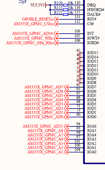

AM335的GPMC接多个设备时用SD卡启动后找不到nand flash?
现在我们做了一块板,GPMC总线接了2个设备,一块256Mbyte的nand flash,使用8-Bit NAND Device模式,一个GPIB协仪芯片,使用的是Non Multiplexed Address Data 8-Bit Device模式,现在有一个奇怪的现像,
1.当接入SD卡,启动项设置为nand启动时没有问题,系统可以正常启动,GPIB芯片也可以正常使用
2.当接入SD卡,启动项设置为SD卡启动时,进到UBOOT找不到nand flash,打印NAND:  No NAND device found!!!,启动到内核后可以正常使用GPIB芯片
3.当接入SD卡,启动项设置为SD卡启动,硬件去掉GPIB芯片时,进到UBOOT可以正常使用nand flash
所以,这个问题总结就是,当从SD卡启动时,GPIB连接到GPMC总线就找不到nand flash,去掉GPIB就可以找到nand flash,当从nand flash启动时,可以启动且启动后GPIB芯片可以正常工作,所以我没想明白是什么地方有冲突,上面的测试都使用的同一个uboot,所以感觉和uboot中的配置无关,以下附上我的硬件配置:

/* Pin mux for gpib module GPIB芯片的引脚配置 */
static struct pinmux_config GPMC_TNT5002_pin_mux[] = {
{"gpmc_ad0.gpmc_ad0", OMAP_MUX_MODE0 | AM33XX_PIN_INPUT_PULLUP},
{"gpmc_ad1.gpmc_ad1", OMAP_MUX_MODE0 | AM33XX_PIN_INPUT_PULLUP},
{"gpmc_ad2.gpmc_ad2", OMAP_MUX_MODE0 | AM33XX_PIN_INPUT_PULLUP},
{"gpmc_ad3.gpmc_ad3", OMAP_MUX_MODE0 | AM33XX_PIN_INPUT_PULLUP},
{"gpmc_ad4.gpmc_ad4", OMAP_MUX_MODE0 | AM33XX_PIN_INPUT_PULLUP},
{"gpmc_ad5.gpmc_ad5", OMAP_MUX_MODE0 | AM33XX_PIN_INPUT_PULLUP},
{"gpmc_ad6.gpmc_ad6", OMAP_MUX_MODE0 | AM33XX_PIN_INPUT_PULLUP},
{"gpmc_ad7.gpmc_ad7", OMAP_MUX_MODE0 | AM33XX_PIN_INPUT_PULLUP},
{"gpmc_a1.gpmc_a1", OMAP_MUX_MODE0 | AM33XX_PIN_OUTPUT},
{"gpmc_a2.gpmc_a2", OMAP_MUX_MODE0 | AM33XX_PIN_OUTPUT},
{"gpmc_a3.gpmc_a3", OMAP_MUX_MODE0 | AM33XX_PIN_OUTPUT},
{"gpmc_a6.gpmc_a6", OMAP_MUX_MODE0 | AM33XX_PIN_OUTPUT},
{"gpmc_a7.gpmc_a7", OMAP_MUX_MODE0 | AM33XX_PIN_OUTPUT},
{"gpmc_a8.gpmc_a8", OMAP_MUX_MODE0 | AM33XX_PIN_OUTPUT},
{"gpmc_csn1.gpmc_csn1", OMAP_MUX_MODE0 | AM33XX_PULL_DISA},
{"gpmc_oen_ren.gpmc_oen_ren", OMAP_MUX_MODE0 | AM33XX_PULL_DISA},
{"gpmc_wen.gpmc_wen", OMAP_MUX_MODE0 | AM33XX_PULL_DISA},
{NULL, 0},

GPIB芯片原理图
