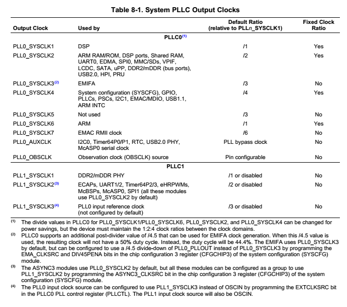

OMAPL138手册上所描述的PLL0_SYSCLK2 used by DDR2/mDDR (bus ports)和PLL1_SYSCLK1 used by DDR2/mDDR PHY,这两个时钟是否需要配置一致的,它们的区别是什么?有相关的详细说明资料参考吗? 谢谢!
  • 在TRM DDR2/mDDR Memory Controller章节有详细的说明
    15.2.1.3 DDR2/mDDR Memory Controller Internal Clock Domains
    There are two clock domains within the DDR2/mDDR memory controller. The two clock domains are driven by VCLK and a divided-down by 2 version of 2X_CLK called MCLK. The command FIFO, write FIFO, and read FIFO described in Section 15.2.6 are all on the VCLK domain. From this, VCLK drives the interface to the peripheral bus. The MCLK domain consists of the DDR2/mDDR memory controller state machine and memory-mapped registers. This clock domain is clocked at the rate of the external DDR2/mDDR memory, 2X_CLK/2.
