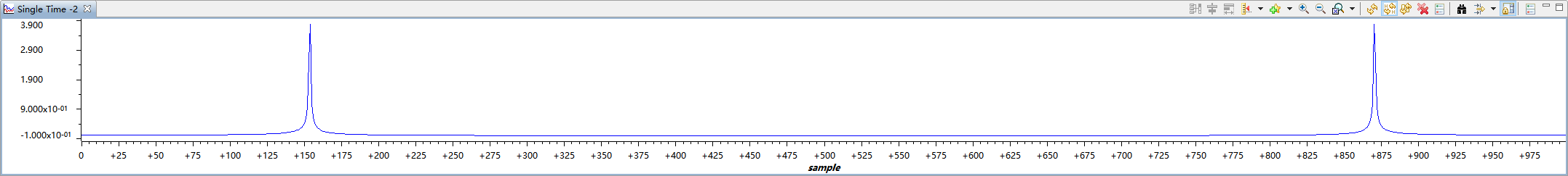

最终结果显示失败,截图如下
首先是这次测试的原始信号,已经加0转换为复数信号了

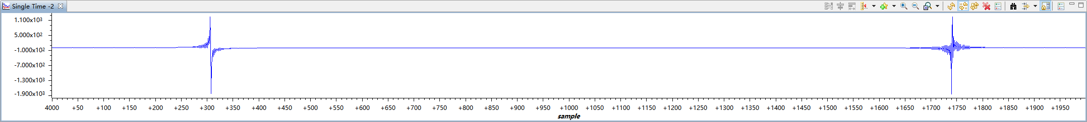

FFT运算结果如下
提取幅值信息后,结果正确

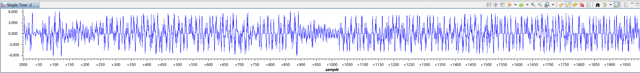

经过ifft逆变换后,结果如下,显然并没有成功还原信息,请问该怎么解决呢?
  • IFFT的旋转因子和FFT的旋转因子符号不一样。
    The following code snippet is an example for single precision twiddle-factor generation taken from the unit test of the function DSPF_sp_fftSPxSP. A similar program (but not identical because of the different sign in the twiddle factor exponent) exists for IFFT.
    www.ti.com/.../sprac64.pdf
