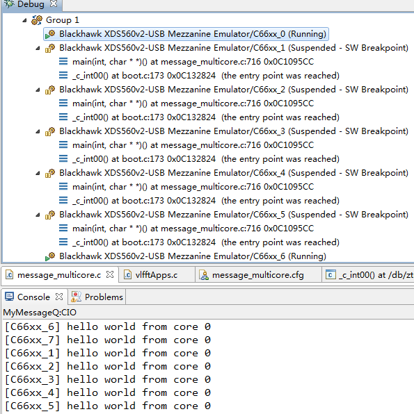

Other Parts Discussed in Thread: SYSBIOS
在main函数通过DNUM函数获取核数打印时候没有打印出核0,在经过Ipc_start()同步后,通过status检测同步正常,但是MutiProc_self()获取不到核0.
  • 您是参考的哪个例程?麻烦贴出来相关的代码以及配置文件。
  •  配置文件如下:
    var MultiProc = xdc.useModule('ti.sdo.utils.MultiProc');
    * Get the list of names that the build device supports.
    * I.e. ["CORE0", "CORE1", "CORE2" ... ]
    //var nameList = MultiProc.getDeviceProcNames();
    //MultiProc.setConfig(null, nameList);
    MultiProc.setConfig(null, ["CORE0", "CORE1", "CORE2", "CORE3", "CORE4", "CORE5", "CORE6", "CORE7"]);

     主函数如下:
    Int main(Int argc, Char* argv[])
    HeapBufMP_Handle   heapHandle;

         * Ipc_start() calls Ipc_attach() to synchronize all remote processors
         * because 'Ipc.procSync' is set to 'Ipc.ProcSync_ALL' in *.cfg
    int coreId = DNUM;
    printf("hello world from core %d\n", coreId);
    int status = Ipc_start();
       if (status < 0) {
           //System_abort("Ipc_start failed\n");
       printf("Ipc_start failed\n");
    printf("I am core %d\n", coreId);
       if (MultiProc_self() == 0) {
       printf("Is in core %d\n", coreId);

  • 您好下面是我的的配置文件和主函数
  • 尝试一下在Multiproc_self前调用MultiProc_setLocalId。
    processors.wiki.ti.com/.../MultiProc_Module
  • 你好我参考vlfft历程,有个setMyId函数,这个函数已经显示调用MultiProc_setLocalId(procId)
  • 您的问题解决了吗?可以将您的project传上来吗?我转给相关的工程师看一下。
