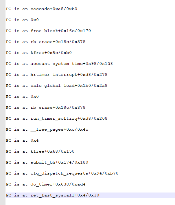

DDR:IS43TR16256A-125KBLI ,PLL:303MHz,EMIF和PHY的配置通过excel计算出来,然后运行过sw leveling
参照购买的demo板,自己做的核心板加底板,使用过程中概率性出现内核崩溃问题,出现频次较大;使用SD卡启动,文件系统只读和读写都会出现崩溃问题;nfs和nand启动同样会出现崩溃。
在购买的demo板上,使用相同的MLO Uboot,内核,文件系统,用SD卡启动,运行app不会出现系统崩溃现象;
出现过问题的时间点:
1.内核启动中出现崩溃
2.app运行期间出现崩溃
3.插拔usb出现崩溃,USB使用host
都是概率性的出现崩溃,每次出问题时,log日志的PC位置都不统一,没有太多共性,进行了大量测试还是没法定位问题。
各位大神,麻烦帮忙看下,能不能提供点检查的思路

[  571.450187] Process FourChannel (pid: 777, stack limit = 0xdf0602f0)

[  571.521104] 1e80: c073fce0 df1340e8 00000000 00000004 e084a800 00000000 df061ef4 df061ea8
[  571.529640] 1ea0: c02ddbac c02d291c df061ecc df061eb8 c0219f3c c003b410 df0e3cfc df061ef0
[  571.538175] 1ec0: 40000193 00000000 00a37e00 df0bf200 c073fce0 00000000 00000000 00000013
[  571.546711] 1ee0: c07279c8 c0727a20 df061f2c df061ef8 c0075490 c02dd9c8 c00bd24c c02c6470
[  571.555246] 1f00: 00000012 c07279c8 c073fce0 00000000 df061fb0 00000000 00516a9c 00516aac
[  571.563781] 1f20: df061f44 df061f30 c0075638 c0075448 c0025038 c07279c8 df061f5c df061f48
[  571.572317] 1f40: c0077cbc c0075610 df061f6c 00000013 df061f6c df061f60 c0075010 c0077c3c
[  571.580852] 1f60: df061f8c df061f70 c00162fc c0074fdc c00bd788 00000013 00000004 fa200000
[  571.589389] 1f80: df061fac df061f90 c0008514 c00162cc 401a65f0 60000010 ffffffff 43a879e8
[  571.597925] 1fa0: 00000000 df061fb0 c00151c0 c00084c8 00000000 00000000 00510238 00000000
[  571.606460] 1fc0: 005101e0 00000000 00000000 43a879e8 00000000 00516a9c 00516aac 005d6fd8
[  571.614997] 1fe0: 00000000 43a879e8 46d32164 401a65f0 60000010 ffffffff dffdf37d d5f7fdff
[  571.623524] Backtrace:
[  571.626087] [<c00aa7e0>] (kfree+0x0/0x150) from [<c02d9274>] (musb_advance_schedule+0x220/0x2e8)
[  571.635259] [<c02d9054>] (musb_advance_schedule+0x0/0x2e8) from [<c02dafec>] (musb_host_tx+0x1a4/0x4ec)
[  571.645066] [<c02dae48>] (musb_host_tx+0x0/0x4ec) from [<c02d2a4c>] (musb_interrupt+0x13c/0x10a4)
[  571.654330] [<c02d2910>] (musb_interrupt+0x0/0x10a4) from [<c02ddbac>] (ti81xx_interrupt+0x1f0/0x578)
[  571.663963] [<c02dd9bc>] (ti81xx_interrupt+0x0/0x578) from [<c0075490>] (handle_irq_event_percpu+0x54/0x1c8)
[  571.674223] [<c007543c>] (handle_irq_event_percpu+0x0/0x1c8) from [<c0075638>] (handle_irq_event+0x34/0x44)
[  571.684395] [<c0075604>] (handle_irq_event+0x0/0x44) from [<c0077cbc>] (handle_level_irq+0x8c/0xf4)
[  571.693832]  r4:c07279c8
[  571.696481] [<c0077c30>] (handle_level_irq+0x0/0xf4) from [<c0075010>] (generic_handle_irq+0x40/0x4c)
[  571.706097]  r4:00000013
[  571.708760] [<c0074fd0>] (generic_handle_irq+0x0/0x4c) from [<c00162fc>] (handle_IRQ+0x3c/0x90)
[  571.717842] [<c00162c0>] (handle_IRQ+0x0/0x90) from [<c0008514>] (omap3_intc_handle_irq+0x58/0x98)
[  571.727186]  r6:fa200000 r5:00000004 r4:00000013
[  571.732021] [<c00084bc>] (omap3_intc_handle_irq+0x0/0x98) from [<c00151c0>] (__irq_usr+0x40/0x60)
[  571.741274] Exception stack(0xdf061fb0 to 0xdf061ff8)
[  571.746543] 1fa0:                                     00000000 00000000 00510238 00000000
[  571.755078] 1fc0: 005101e0 00000000 00000000 43a879e8 00000000 00516a9c 00516aac 005d6fd8
[  571.763612] 1fe0: 00000000 43a879e8 46d32164 401a65f0 60000010 ffffffff
[  571.770508]  r7:43a879e8 r6:ffffffff r5:60000010 r4:401a65f0
[  571.776432] Code: 1590001c e5903000 e3130080 1a000001 (e7f001f2)
y...------------------------------ status is 0
[  571.782873] ---[ end trace fd55952be2e706ce ]---

[  463.900800] usb 1-1.3: reset high-speed USB device number 4 using musb-hdrc
[  467.405437] Unable to handle kernel NULL pointer dereference at virtual address 00000150
[  467.413900] pgd = c0004000
[  467.416720] [00000150] *pgd=00000000
[  467.420460] Internal error: Oops: 17 [#1]
[  467.424640] Modules linked in:
[  467.427830] CPU: 0    Not tainted  (3.2.0 #42)
[  467.432483] PC is at cfq_dispatch_requests+0x94/0xb70
[  467.437752] LR is at __cfq_slice_expired+0x1d4/0x3f0
[  467.442931] pc : [<c01cc63c>]    lr : [<c01ca0f8>]    psr: 60000093
[  467.442939] sp : df45def8  ip : df45dec0  fp : df45df4c
[  467.454909] r10: df447800  r9 : df42a00c  r8 : 00000000
[  467.460357] r7 : df1fe904  r6 : 00000000  r5 : 00000000  r4 : df44f7a8
[  467.467164] r3 : 00000000  r2 : 00000000  r1 : df44f7a8  r0 : 00000000
[  467.473975] Flags: nZCv  IRQs off  FIQs on  Mode SVC_32  ISA ARM  Segment kernel
[  467.481689] Control: 10c5387d  Table: 9f5a4019  DAC: 00000015
