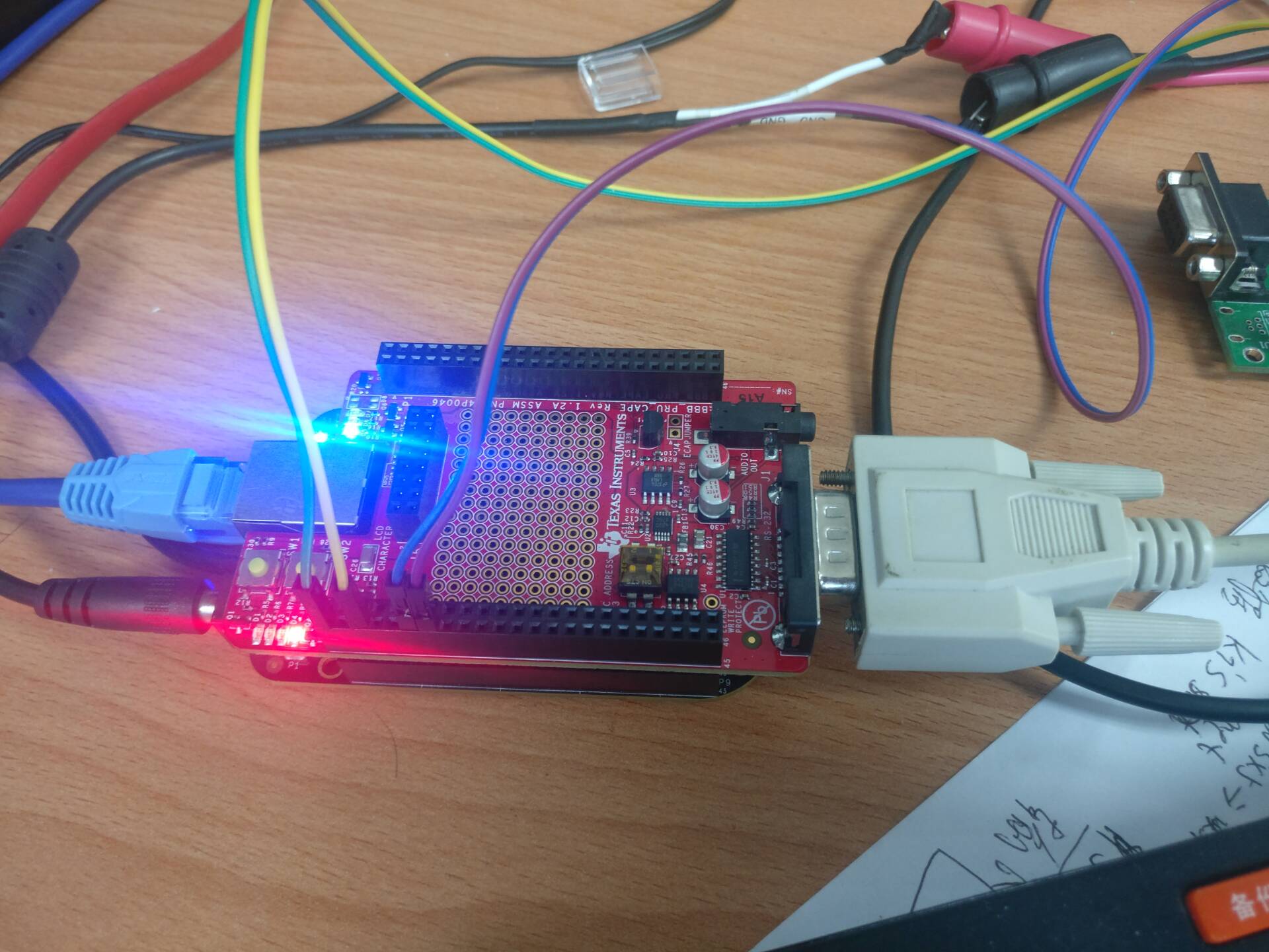

请问am3358 pru内部的uart能用吗?
最近有需求需要用到am335x的pru,我在boneblack board 配合pru cape board 能跑通 pru的led 的例程,但唯独pru内部的uart(非sw uart)无法使用,请问有人使用过吗?
dts:
&am33xx_pinmux {
pru_cape_bone_pins: pru_cape_bone_pins {
pinctrl-single,pins = <
0x1a4 0x2e /* mcasp0_fsr, OMAP_MUX_MODE6 | AM33XX_PIN_INPUT, PRU CAPE SW1 */
0x1ac 0x2e /* mcasp0_ahclkx, OMAP_MUX_MODE6 | AM33XX_PIN_INPUT, PRU CAPE SW2 */
0x19c 0x05 /* mcasp0_ahclkr, OMAP_MUX_MODE5 | AM33XX_PIN_OUTPUT, PRU CAPE Red LED */
0x198 0x05 /* mcasp0_axr0, OMAP_MUX_MODE5 | AM33XX_PIN_OUTPUT, PRU CAPE Orange LED */
0x190 0x05 /* mcasp0_aclkx, OMAP_MUX_MODE5 | AM33XX_PIN_OUTPUT, PRU CAPE Blue LED */
0x194 0x05 /* mcasp0_fsx, OMAP_MUX_MODE5 | AM33XX_PIN_OUTPUT, PRU CAPE Green LED */
0x0ac 0x05 /* lcd_data3, OMAP_MUX_MODE5 | AM33XX_PIN_OUTPUT, PRU CAPE RGB_0 LED, HDMI Conf. */
0x0b0 0x05 /* lcd_data4, OMAP_MUX_MODE5 | AM33XX_PIN_OUTPUT, PRU CAPE RGB_1 LED, HDMI Conf. */
0x0b4 0x05 /* lcd_data5, OMAP_MUX_MODE5 | AM33XX_PIN_OUTPUT, PRU CAPE RGB_2 LED, HDMI Conf. */
0x0a0 0x05 /* lcd_data0, OMAP_MUX_MODE5 | AM33XX_PIN_OUTPUT, PRU CAPE Audio Data, HDMI Conf. */
0x0a4 0x05 /* lcd_data1, OMAP_MUX_MODE5 | AM33XX_PIN_OUTPUT, PRU CAPE Audio Clk, HDMI Conf. */
0x0a8 0x05 /* lcd_data2, OMAP_MUX_MODE5 | AM33XX_PIN_OUTPUT, PRU CAPE Audio Sync, HDMI Conf. */
0x184 0x05 /* uart1_txd, OMAP_MUX_MODE5 | AM33XX_PIN_OUTPUT, PRU CAPE PRU UART txd */
0x180 0x2d /* uart1_rxd, OMAP_MUX_MODE5 | AM33XX_PIN_INPUT, PRU CAPE PRU UART rxd */
0x154 0x04 /* spi0_d0, OMAP_MUX_MODE4 | AM33XX_PIN_OUTPUT, PRU CAPE PRU UART rts */
0x150 0x2c /* spi0_sclk, OMAP_MUX_MODE4 | AM33XX_PIN_INPUT, PRU CAPE PRU UART cts */
0x0b8 0x04 /* lcd_data6, OMAP_MUX_MODE4 | AM33XX_PIN_OUTPUT, PRU CAPE LCD rs t3 */
0x0e8 0x04 /* lcd_pclk, OMAP_MUX_MODE4 | AM33XX_PIN_OUTPUT, PRU CAPE LCD e v5 */
0x158 0x06 /* spi0_d1, OMAP_MUX_MODE6 | AM33XX_PIN_OUTPUT, PRU CAPE LCD data4 b16 */
0x15c 0x06 /* spi0_cs0, OMAP_MUX_MODE6 | AM33XX_PIN_OUTPUT, PRU CAPE LCD data5 a16 */
0x0e0 0x04 /* lcd_vsync, OMAP_MUX_MODE4 | AM33XX_PIN_OUTPUT, PRU CAPE LCD data6 u5 */
0x0e4 0x04 /* lcd_hsync, OMAP_MUX_MODE4 | AM33XX_PIN_OUTPUT, PRU CAPE LCD data7 r5 */
0x038 0x2e /* gpmc_ad14, OMAP_MUX_MODE6 | AM33XX_PIN_INPUT, PRU CAPE Temp Input */
/*0x0bc 0x04*/ /* lcd_data7, OMAP_MUX_MODE4 | AM33XX_PIN_OUTPUT, PRU CAPE Temp Output, Alpha Boards */
0x0ec 0x04 /* lcd_ac_bias_en, OMAP_MUX_MODE4 | AM33XX_PIN_OUTPUT, PRU Cape Temp Output */
