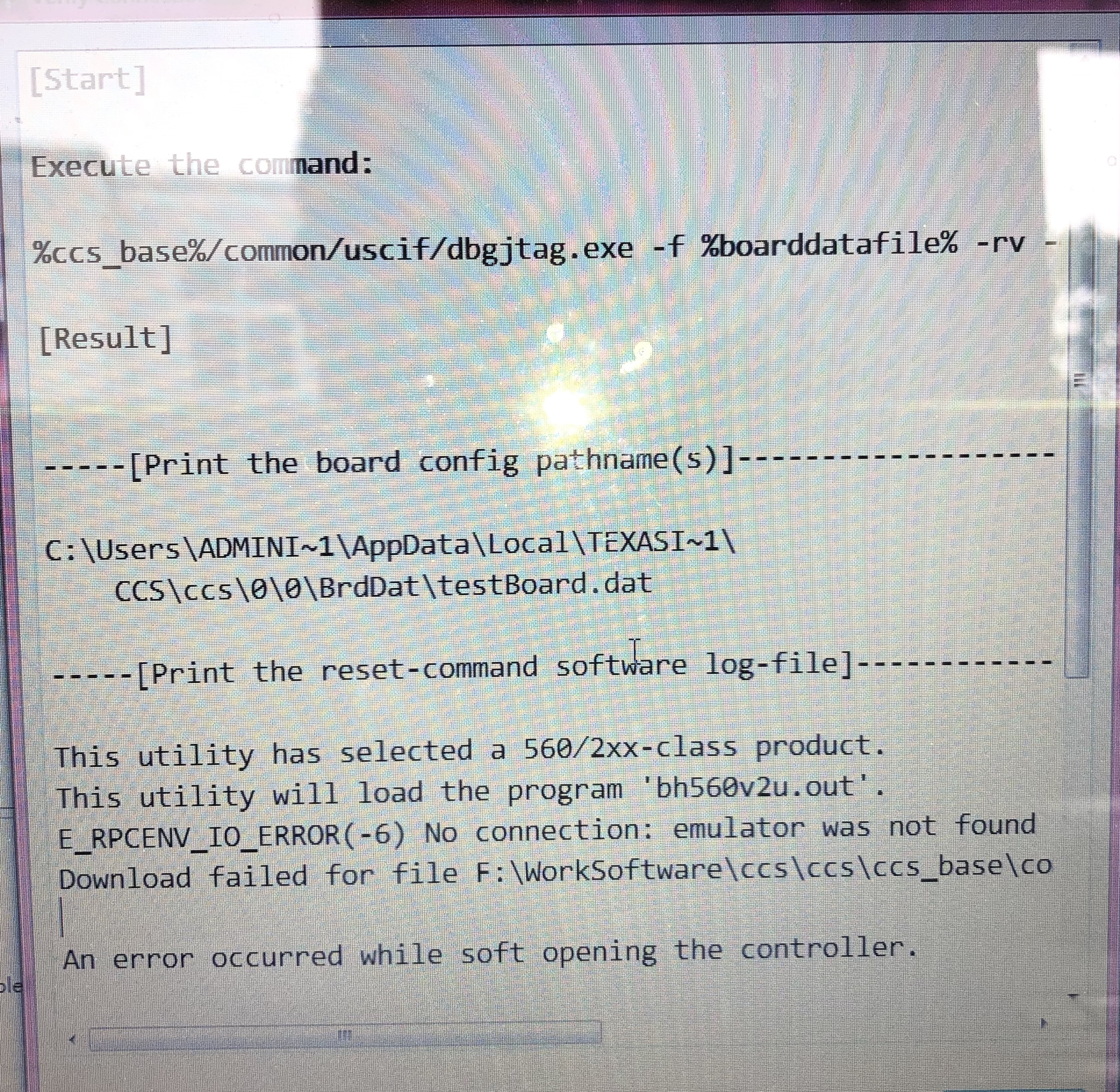

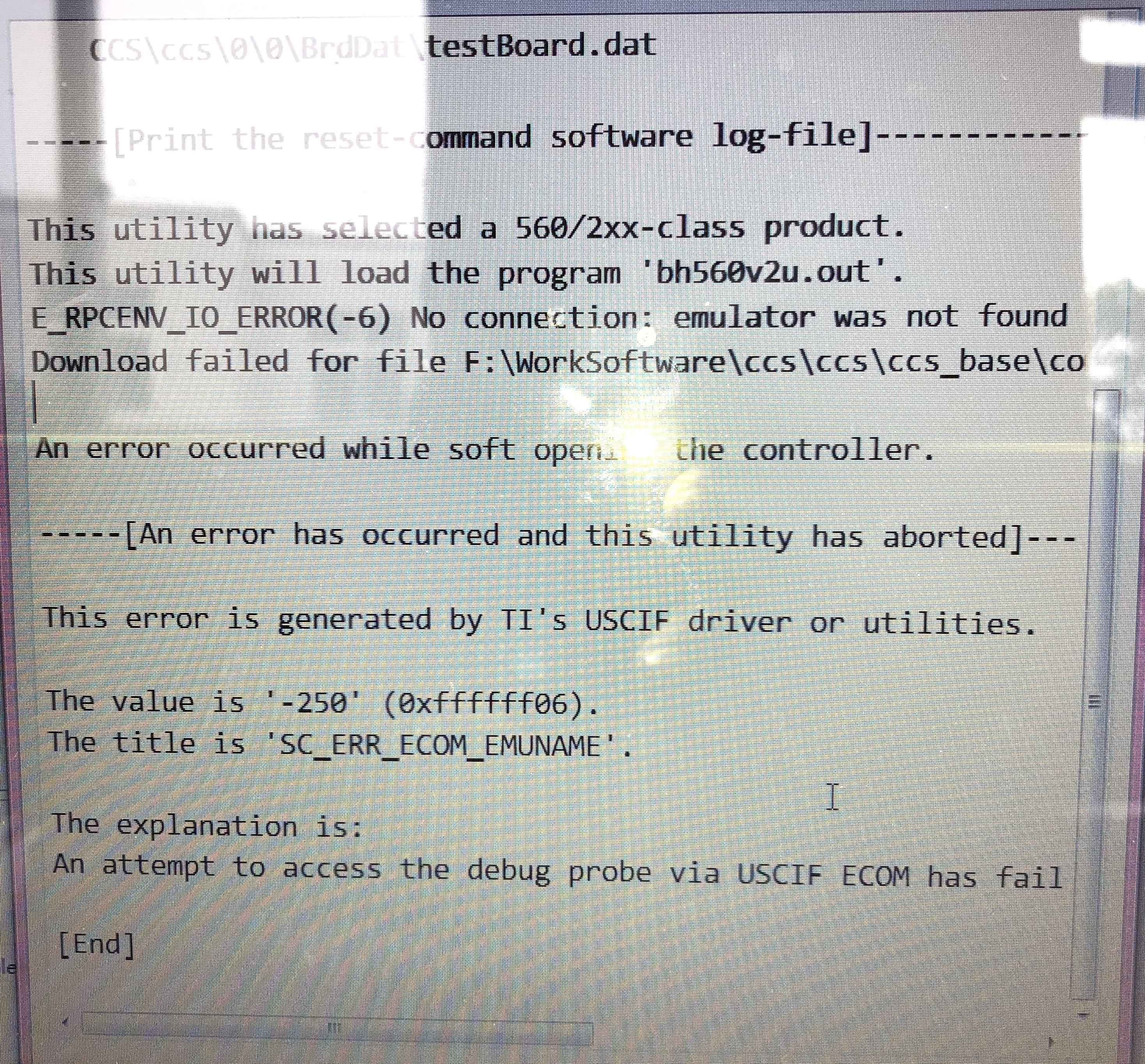

仿真器进入safe mode了,试试下面的方法。
13. Emulator initialization fails, Yellow (D5) and Orange (D6) LEDs on XDS560v2 Mezzanine board are blinking simultaneously. What is the problem? www.einfochips.com/.../C6657-Lite-EVM_FAQ.pdf
