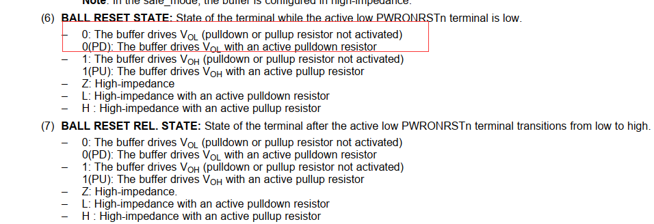

0: The buffer drives VOL (pulldown or pullup resistor not activated) 和1: The buffer drives VOH (pulldown or pullup resistor not activated) 可以理解成为是一种引脚悬空状态吗?
