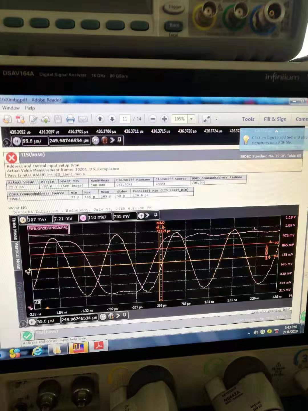

用示波器测量CK1和WE信号在1600MHZ下时序关系比较紧张,请问6678的DDR3控制器通过什么方法来调整时钟和命令线的关系或者有办法调整时钟输出的相位吗?如1/4相位。
下图是WE和CK1这组的关系:
  • 请看下面的勘误表Usage Note 14 DDR3 Performance Limited to 1333MT/s Usage Note
    The DDR3 interface is currently limited to a maximum transfer rate of 1333MT/s. It can be configured to operate at any rate from 800MT/s to 1333MT/s. This coincides with DDR3 clock rates from 400MHz to 666.5MHz.
    www.ti.com/.../sprz334h.pdf
