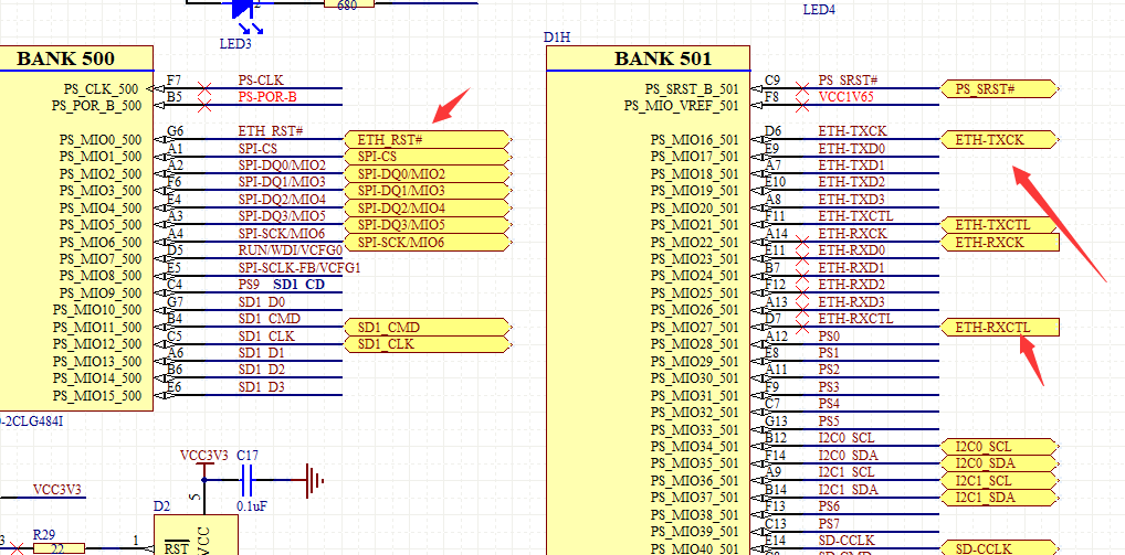

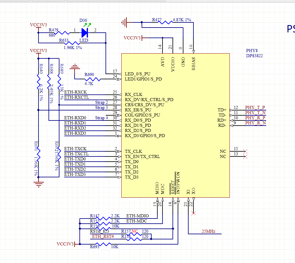

zynq xilinx-release2019.02.01版本使用DP83822可以识别无法ping通

libphy: Fixed MDIO Bus: probed
CAN device driver interface
libphy: MACB_mii_bus: probed
TI DP83822 e000b000.ethernet-ffffffff:1f: attached PHY driver [TI DP83822] (mii_bus:phy_addr=e000b000.ethernet-ffffffff:1f, irq=POLL)
macb e000b000.ethernet eth0: Cadence GEM rev 0x00020118 at 0xe000b000 irq 27 (00:0a:35:00:01:22)

  • 我对应的硬件连线方式如下
    我的设备树文件dts如下采用的是zynq-zc702.dts
