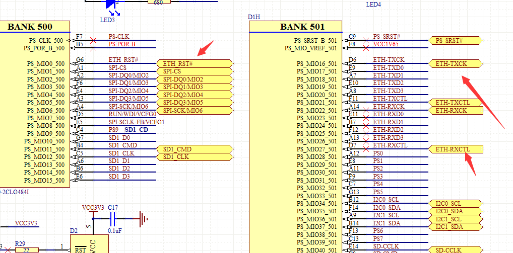

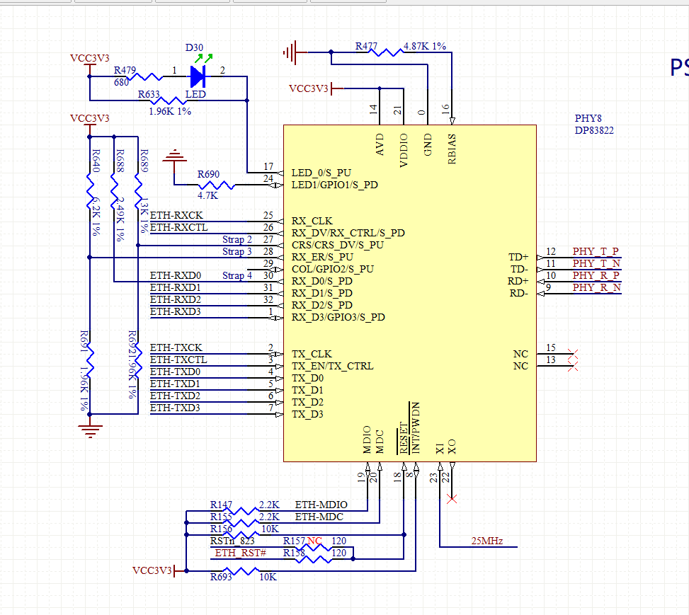

zynq xilinx-linux2019.02.01 使用DP83822可识别无法ping通

TI DP83822 e000b000.ethernet-ffffffff:1f: attached PHY driver [TI DP83822] (mii_bus:phy_addr=e000b000.ethernet-ffffffff:1f, irq=POLL)
macb e000b000.ethernet eth0: Cadence GEM rev 0x00020118 at 0xe000b000 irq 27 (00:0a:35:00:01:22)

启动打印信息,可以识别加载对应的驱动,但是无法ping通,我的硬件连接如下
我使用的是zynq-zc702.dts编译的对应dtb,
