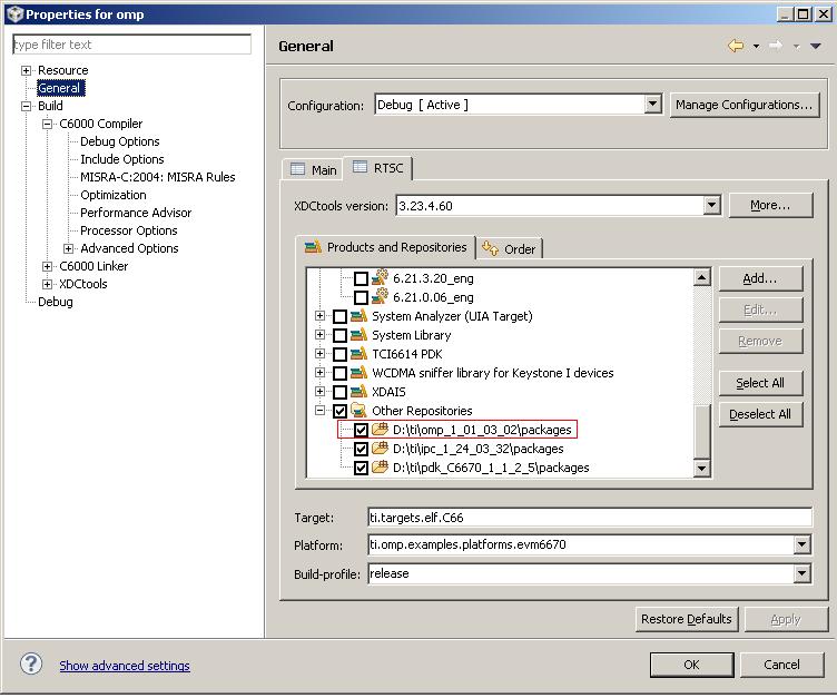

OMP问题
这个问题是下面网址上的一个例子:6.2.3.1
http://processors.wiki.ti.com/index.php/BIOS_MCSDK_2.0_User_Guide#Compiling_OpenMP_code_with_the_TI_compiler_using_Makefile
我的平台:软件:CCSv5.2; 硬件平台:6678EVM;
CCS报错界面见附件里面。
下面是console报错信息:
**** Build of configuration Debug for project Hello_World_example ****
F:\ti\ccsv5\utils\bin\gmake -k all
'Building file: ../helloworld.cfg'
'Invoking: XDCtools'
"F:/ti/xdctools_3_23_04_60/xs" --xdcpath="F:/ti/ipc_1_24_03_32/packages;F:/ti/mcsdk_2_01_02_06/demos;F:/ti/pdk_C6678_1_1_2_6/packages;F:/ti/omp_1_01_03_02/packages;F:/ti/bios_6_33_05_46/packages;F:/ti/uia_1_01_00_04/packages;F:/ti/ccsv5/ccs_base;" xdc.tools.configuro -o configPkg -t ti.targets.elf.C66 -p ti.platforms.evm6678 -r release -c "F:/Program Files/Texas Instruments/C6000 Code Generation Tools 7.4.1" "../helloworld.cfg"
making package.mak (because of package.bld) ...
generating interfaces for package configPkg (because package/package.xdc.inc is older than package.xdc) ...
configuring helloworld.xe66 from package/cfg/helloworld_pe66.cfg ...
js: "F:/ti/omp_1_01_03_02/packages/ti/omp/utils/OpenMP.xs", line 142: TypeError: Cannot read property "base" from undefined (F:/ti/omp_1_01_03_02/packages/ti/omp/utils/OpenMP.xs#142)
    "F:/ti/omp_1_01_03_02/packages/ti/omp/utils/OpenMP.xs", line 105
gmake.exe: *** [package/cfg/helloworld_pe66.xdl] Error 1
js: "F:/ti/xdctools_3_23_04_60/packages/xdc/tools/Cmdr.xs", line 51: Error: xdc.tools.configuro: configuration failed due to earlier errors (status = 2); 'linker.cmd' deleted.
gmake: *** [configPkg/compiler.opt] Error 1
gmake: Target `all' not remade because of errors.
**** Build Finished ****
